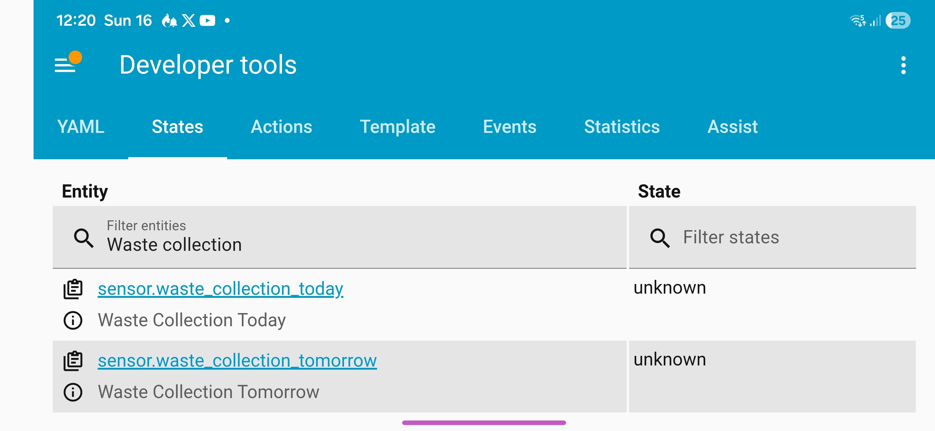

Please, where am I going wrong in my template, as the states are showing unavailable?
