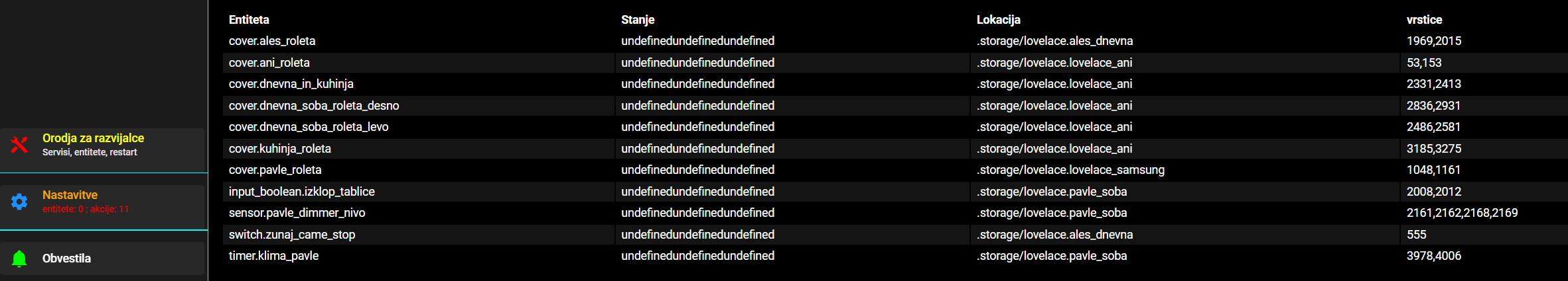

Funny thing… with latest rc2 my error above indeed dissapears, but i get a different “problem”: 11 missing actions, although they should be entities… ? These are not shown on old version, and also it can happen that they are not shown in this one after HA restart, but not always. 2 days ago when i first installer rc2 errors showed, but dissapeared after HA restart. But today HACS update rebooted went through and errors stays, even after a couple of HA reboots…

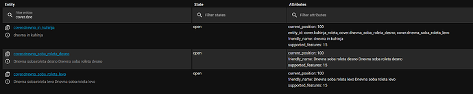

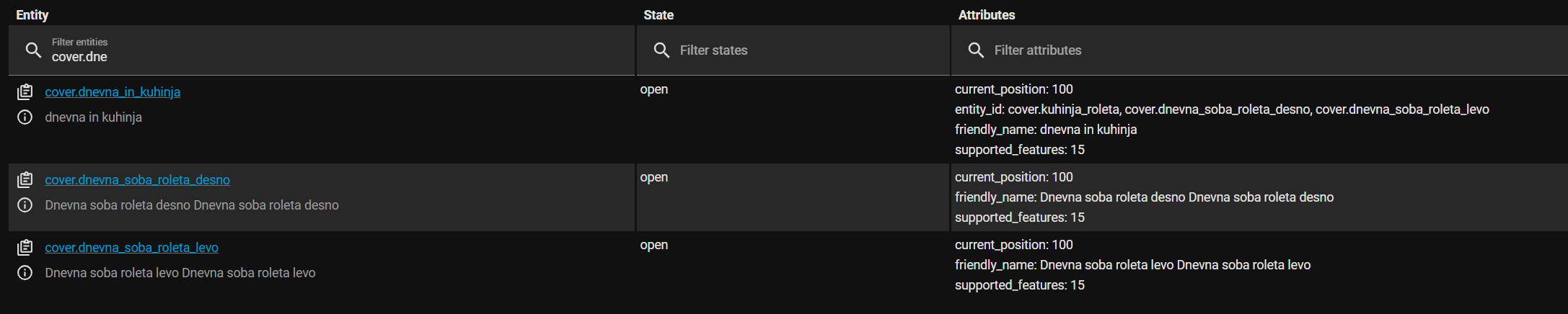

Funny thing is that there are random entities on random dashboards. Note that all reported entities are in fact here and alive.
Note info on the left of the picture, when it says 11 missing actions (akcije):
and proof that entities are not unavailable:

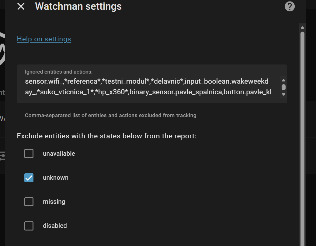

OK, thanks, in rc3 wrong actions are corrected. But, it seems that now watchman still reports unknown entities, although i set them as excluded in settings ?
these entities are from ld2410 sensor, which are only “values” when i have engineering mode turned on (which is only for testing).
works perfectly, thank you! i re-enabled the addon.
