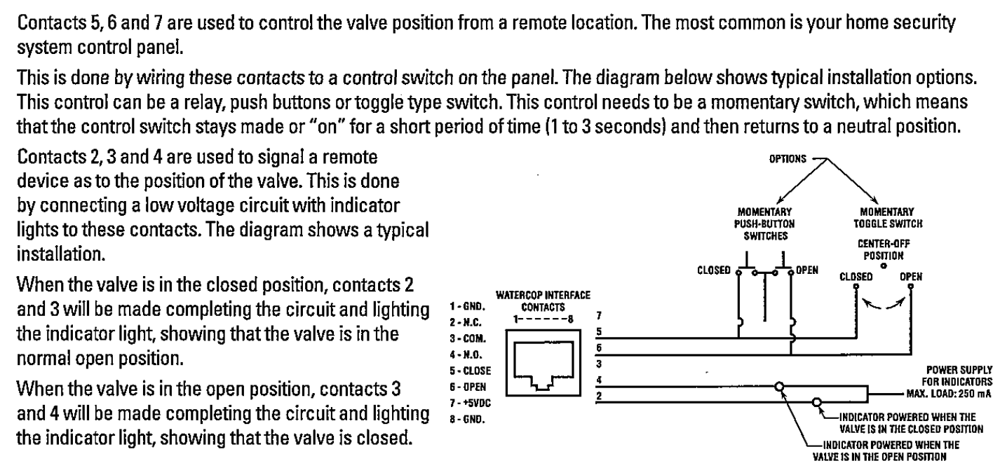

The ball valves work fine if I go to valve and manually press switch. I was looking to put it under automation control. I was trying not to build a hardware controller board to enable to connect the valve. There is a listing of the 4 lines which can be accessed through a cat wire connected through an rJ45 connector. I really wanted to see if I could find something that came working out of the box so I just had the work an integration. It looks like I can replace the entire assembly with something like a Frizzlife LP365 and use the Tulo? integration. This would require me to cut existing valve out and replace. I was trying to be minimally evasive if possible.

You can control that with Shelly uni for example.

Thanks for the direction. It looks like the following product will allow me to connect existing valve assembly to home assistant and meet all the other desires. It looks like I can send the signals to control the valve. I will get one and see if I can figure out if it can give state information for the valve in addition to allowing me to turn it on and off.
Shelly 1 Mini Gen3 | WiFi Smart Switch Relay 1 Channel 8A
Shelly 1 will work as well, but you would need two of them, one for each button…
I ordered one before I read your message. I will get it in my hands and play with it. Looking at schematic I think I understand your 2 device comment. I learn faster when I actually try to wire device.

You can wire Shelly relay I/O for 6/7 or 5/7 (open or close).
Remember to set up “auto-off timer” for ~1s.
