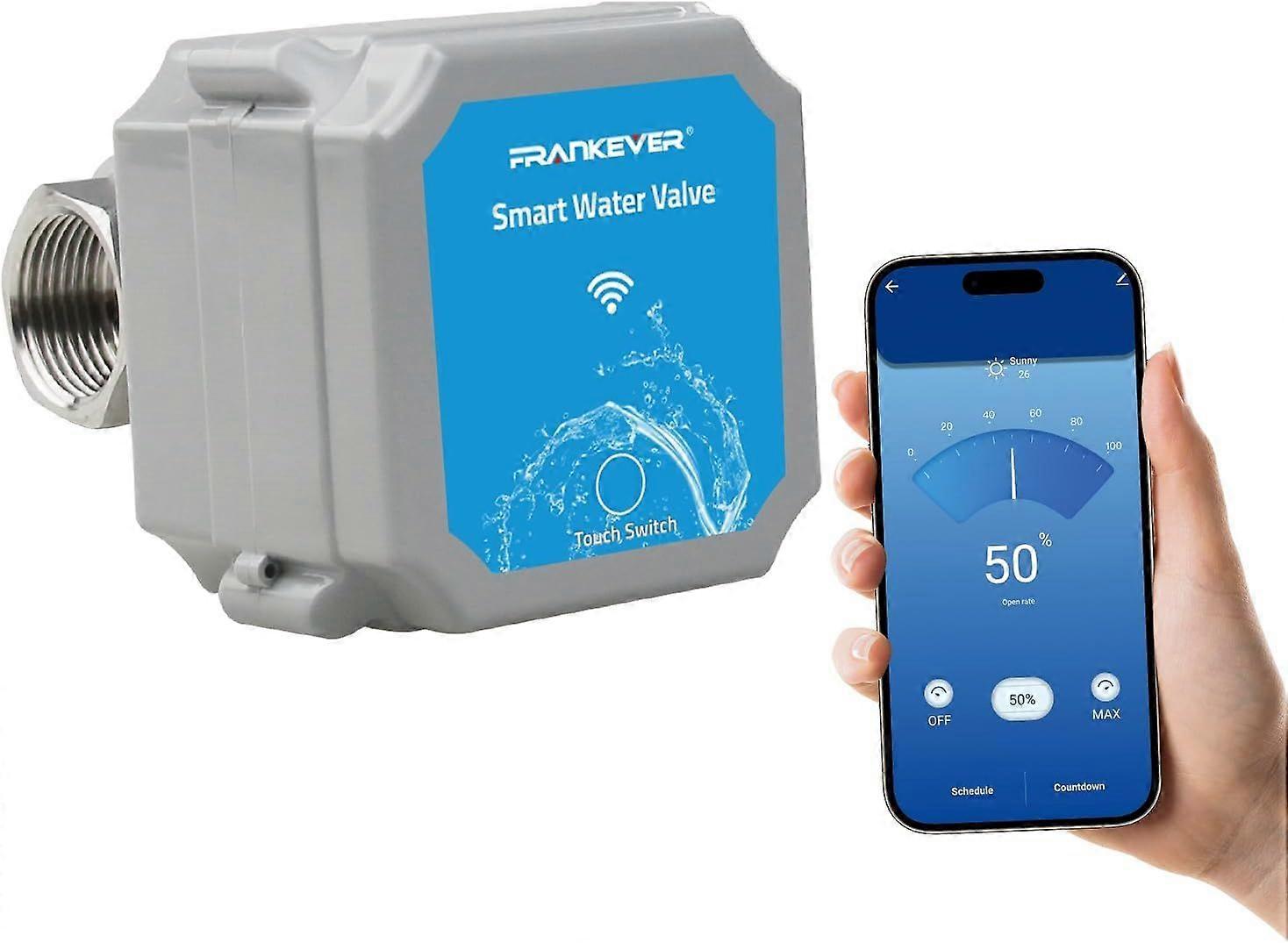

You can use one of these at your house’s water pipe entry point. The only issue is that you need to automate to keep it open all the time as they have a built in timer to shut off… or pull it apart and force it open.
SONOFF Zigbee Smart Water Valve | SWV-BSP/SWV-NH
