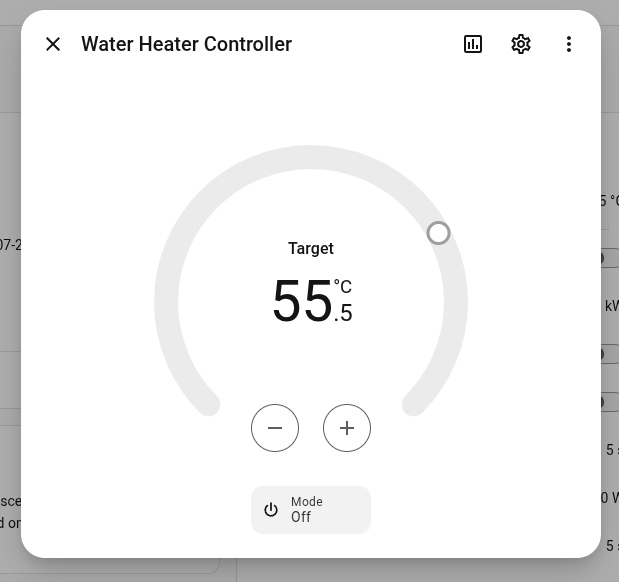

I’m struggling to get my water heater device to publish target temperature changes to the HA activity log. I’ve tried every example I can find and everything Claude and Gemini suggest but nothing works, not sure if I’m being stupid or there’s some bug or what…
Changing the mode is reflected in the activity log just fine

Changes to the target_temperature are saved, but do not appear in the Activity Log.
Other entities declared on the same device also reflect their changes in the activity log
What am I missing?

In the UI, I adjust the target temp, this is stored correctly, but never published to the activity log

If I change the Mode, its in the Activity Log. If I change the target temperature, it is not.

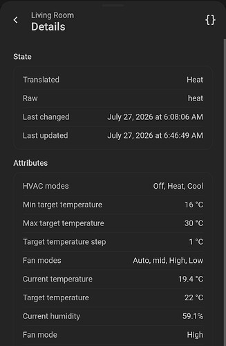

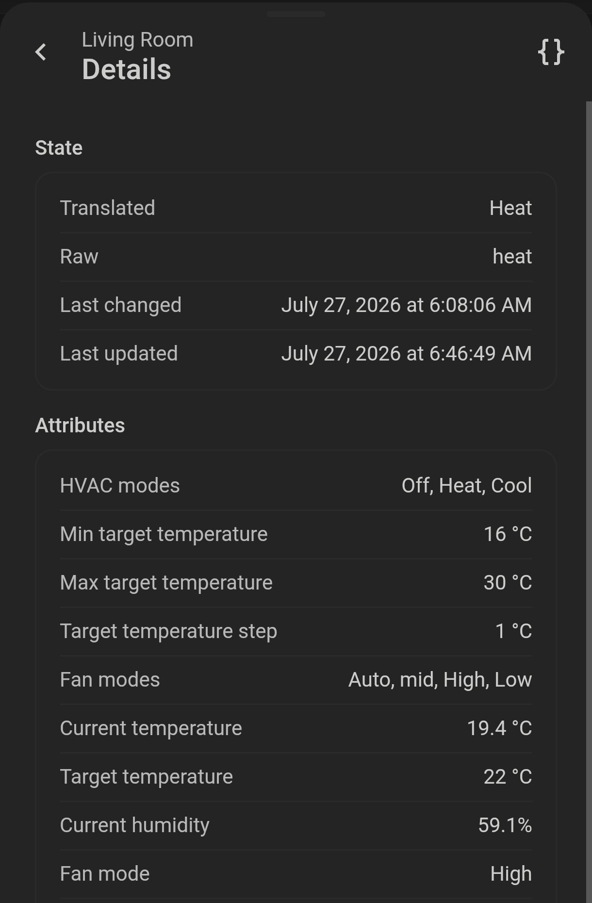

But is target temperature perhaps stored as an attribute on the HA side (rather than a state)?
A bit like this.
… What do you see on your image above if you go to the “details” menu?

Just tested this with a climate entity and they don’t publish activity for target temp changes either, as they are attributes there too.
OK, thanks for helping me understand
I think what I do when I need to access the target temp a lot is to create a dedicated sensor for it.
So like a template sensor that refers to the attribute. On either the ESPHome or HA side.
Yes, to wrap a bow on this topic:
The activity log only tracks entity state changes. It does not track attribute changes. (And it also doesn’t track state changes to sensor entities that have a unit_of_measurement).
If there is an attribute you’d like to show up in the activity log, then create a template sensor so that the attribute becomes the state of that new entity. You can use a template like this for a sensor template helper: {{ state_attr('water_heater.living_room', 'target_temperature') }}
