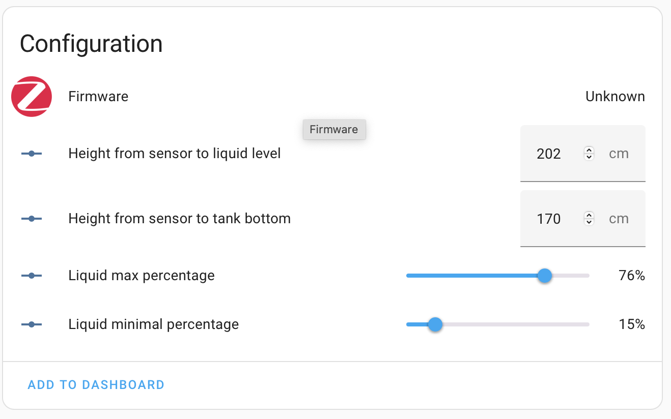

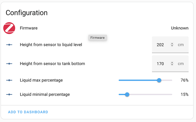

I can report that I just connected this device successfully to ZHA - see below. The steep drop in liquid depth is from not having it on the tank after successfully pairing. Look to the right and you can see a subtle slope. That’s me opening a bunch of consumers to see if the level updates.
After a few minutes it looks like the depth is work, the fill % maybe not. Settings show up in the device’s UI. The two distance settings are called “Water Tank Sensor Height from sensor to liquid level” and “Water Tank Sensor Height from sensor to tank bottom”. Once I make the first number be larger than the second number the percentage changes from 100%. My hunch is now that the first config option is just mislabeled and that one of the measures is sensor height from bottom and the other is max water height from bottom.
I had the toughest time getting the device into pairing mode. The initial blink when connection power is slow. Simply holding the button for 5 seconds didn’t make it a fast blink. I found instructions to “press once, then light will dim, then hold for 5s”. I tried that… Didn’t seem to work. In the end, I feel like I was just tapping slow and fast and suddenly got a fast blink and by HA immediately picked it up…

Can you confirm the mislabeling and show your values? I don’t see the full name in your screenshot.
Thanks in advance
I can confirm they are mislabeled.
This device is weird. It was working when the values were switched up. I did a few power cycles and deleting from the network and re-adding it etc but NOW it is no longer needed to switch up the values. No idea why, it’s just weird.
I was struggling with the level value always showing up 100 percent. Once I switched the values it shows up correctly.

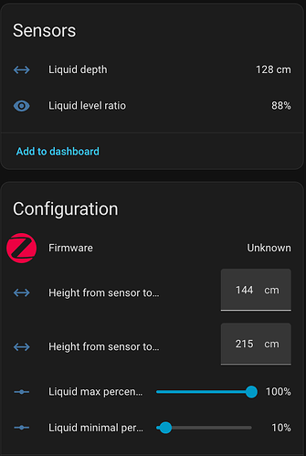

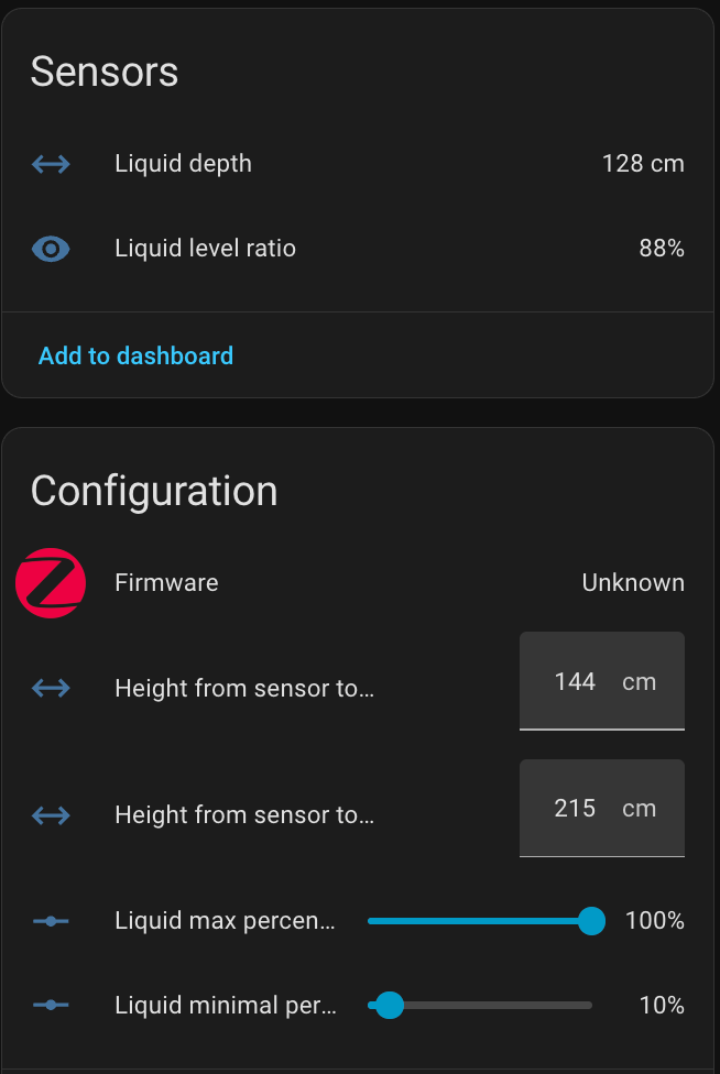

I'm also getting some weird issues with configuring this.
My sensor is 2.3m from the bottom of my tank and 0.2m from its max level so I'm assuming I need to put "Liquid depth max" as 2.1m
When I do it sometimes stays set to those values other times it switches to a -4529193.04, but I only see that in Zigbee2MQTT not in Home Assistant.
I was showing the depth initially at about 2.02m then it randomly jumped up to 4.6m and then it's now at -0.45m for some random reason.
Works perfectly for me.
The first value is mislabeled, it is the maximal height of water level in cm.
(From bottom until where you want to have 100% value)
