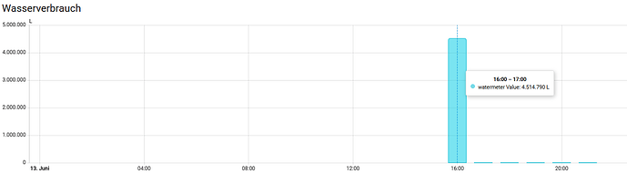

I have an esp cam with AI on the edge installed reading my analog water meter. Two days before I notice a glitch in the dashboard.
Here are my findings:

Once the state flipped from 3 to 4 digits it seems to have a glitch in building the sum, resulting in this output on the enery dashboard:
Is there a chance of a bug? Did I do something wrong in the configuration?
Thanks for any hint.
