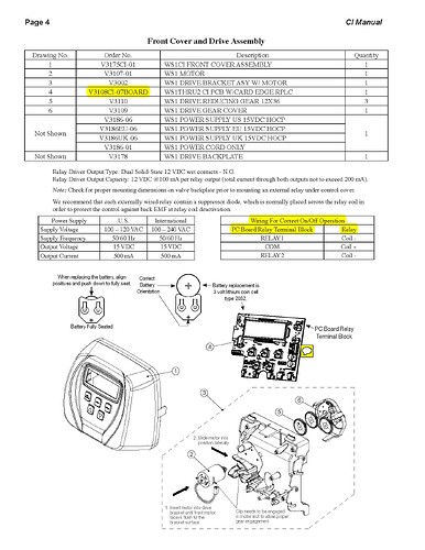

I already have a WS1 as an iron filter and want to buy a second one for my softener. For some reason 5 buttons-2 rows WS1 control board with the relay output seems to be impossible to find here in Canada. I tried sending an email to Clack directly but does not have much hope in getting a reply. Anyone here have a valid link to get a WS1 with the optional relay outputs. Thanks
