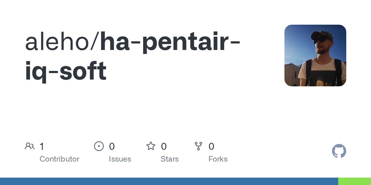

Here’s my custom integration that works for my device after setting it up with the vendor app.
