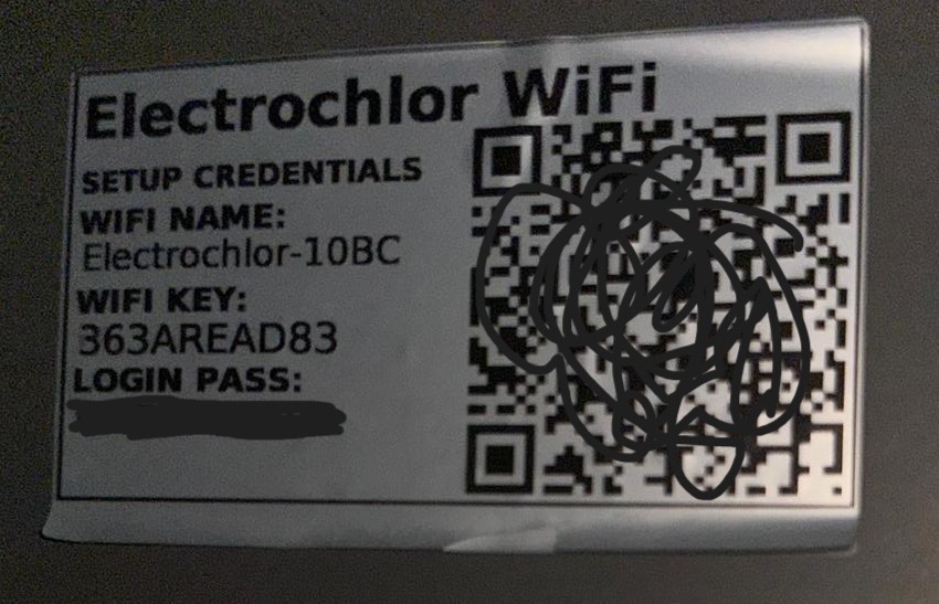

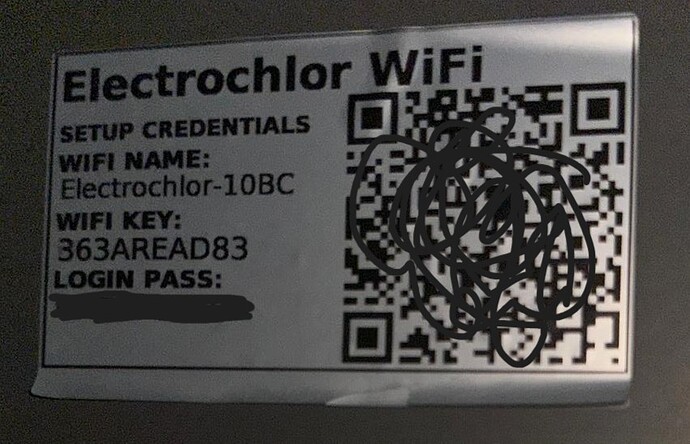

What model do you have.
If it is a model that has WiFi it will have a sticker on the side of the unit like the one below.
To connect your phone to the chlorinator hotspot and set the unit to connect to your wifi.
Thanks. I don’t have one yet, I am looking at getting one and want to make sure I get the right model as I can’t see any details about them being able to connect over Wifi
I have the below unit and it has reference to their app in the brochure. If you are looking a another model, ask the shop that you are purchasing from.
