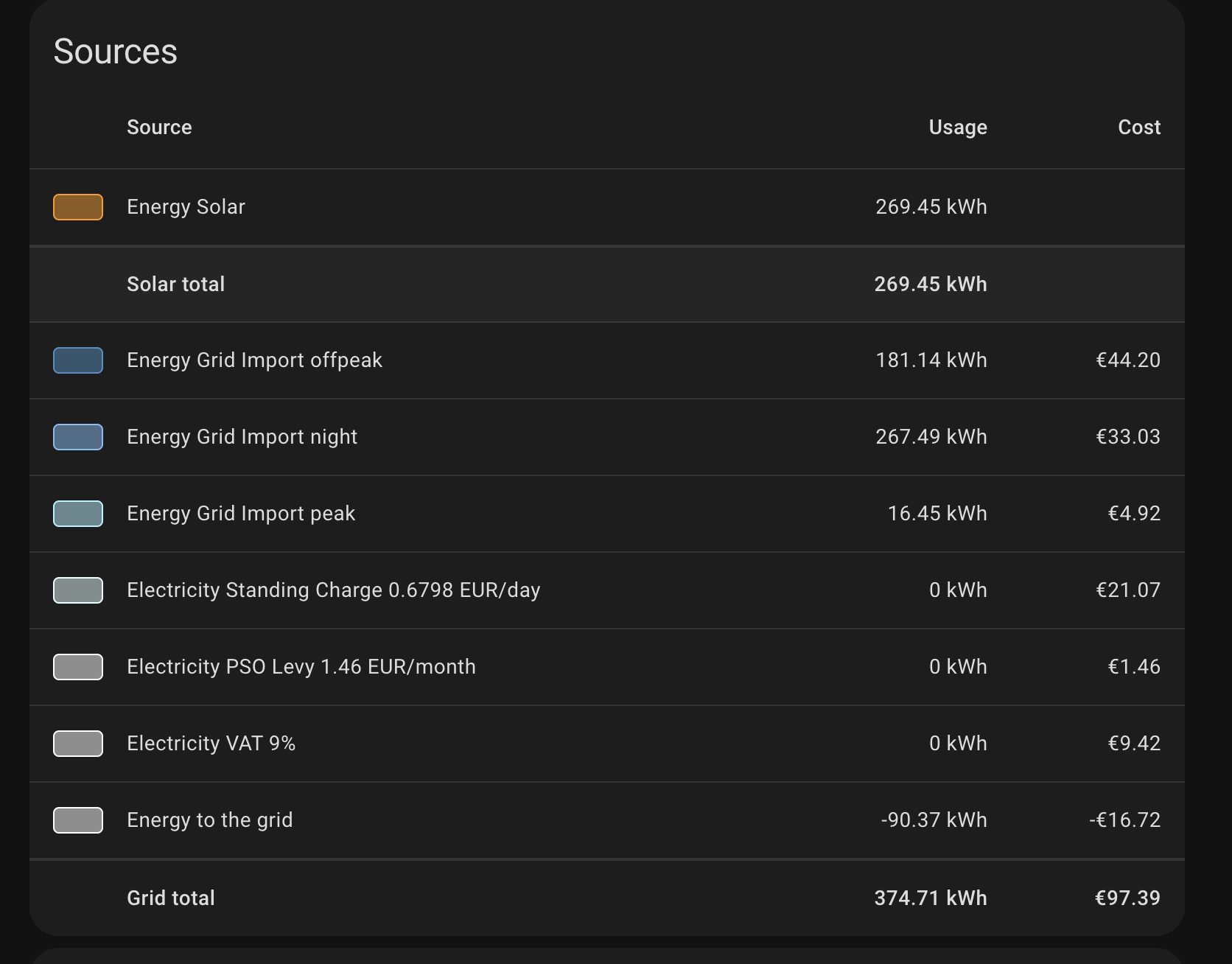

The Energy dashboard does one thing: kWh times price. But my actual bill also has a standing charge, a PSO levy and 9% VAT on top of all of it, and that’s about a quarter of what I pay. So the dashboard said one number, the bill said another, and I could never tell which one was lying.
So I built WattElse. It adds those charges as their own lines on the Energy dashboard:
Day Units        0.2440 /kWh      44.20Night Units      0.1235 /kWh      33.03Peak Units       0.2990 /kWh       4.92Standing Charge  0.6798 /day      21.07PSO Levy         1.46 /month       1.46VAT 9%                             9.42Export credit                    -16.72                               --------                                  97.39
My actual bill for that period was 97.38. One cent off, and that cent is just my supplier rounding each line before adding them up.
