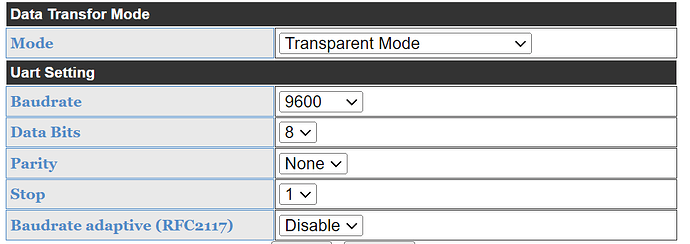

Has anyone succeeded in connecting Wattsonic G3 using this device? https://www.waveshare.com/wiki/RS485_TO_WIFI/ETH#Documentation
It looks like no communication between this device and G3.
What I did:
I enabled termination of EMS port in the connector

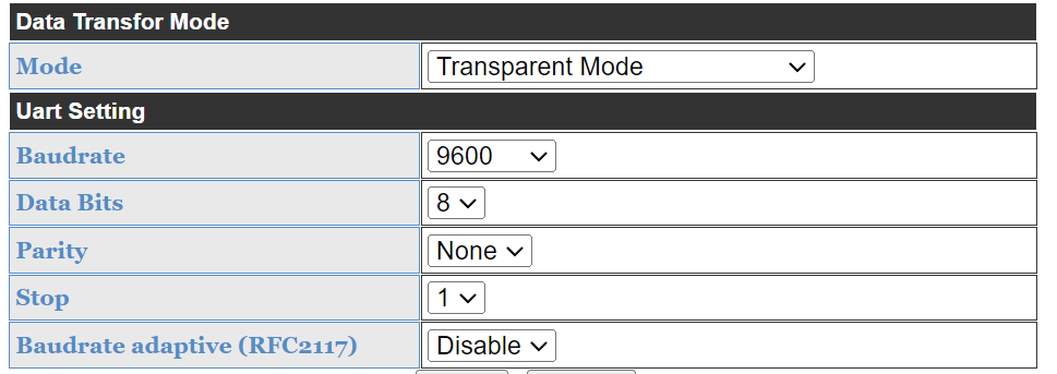

I set UART to:
I tried baudrate adaptive as active too

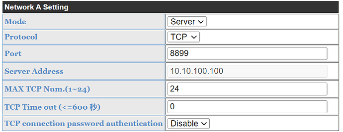

The network setting is as below. Gizmos configuration refers to port 502. I believe this is the same thing. HA doesn’t connect to 502 at all, it attempts to 8899 (as configured see below) and failed.
HA gets no data.
2024-08-04 20:56:51.626 INFO (MainThread) [homeassistant.components.modbus.modbus] modbus wattsonic communication open
2024-08-04 20:56:54.974 ERROR (MainThread) [homeassistant.components.modbus.modbus] Pymodbus: wattsonic: Error: device: 247 address: 10000 -> Modbus Error: [Input/Output] ERROR: No response received after 3 retries
In MQTT (I set the Waveshare device to send data to MQTT), I found a topic “will = offline”
Connectivity led on G3 should blink but it’s constantly lit green.
I have no idea how to debug it further.
I appreciate any help
Hi, I have port 4196 set on the converter and the same port in the HA configuration in the wattsonic.yaml file.
Did I look at the tutorial?
The tutorial doesn’t answer my question.
But I figured this out thanks to one Wattsonic Czech FB group member.
I used to have selected wrong Data Transfer Mode.
The proper one is Modbus TCP <=> Modbus RTU

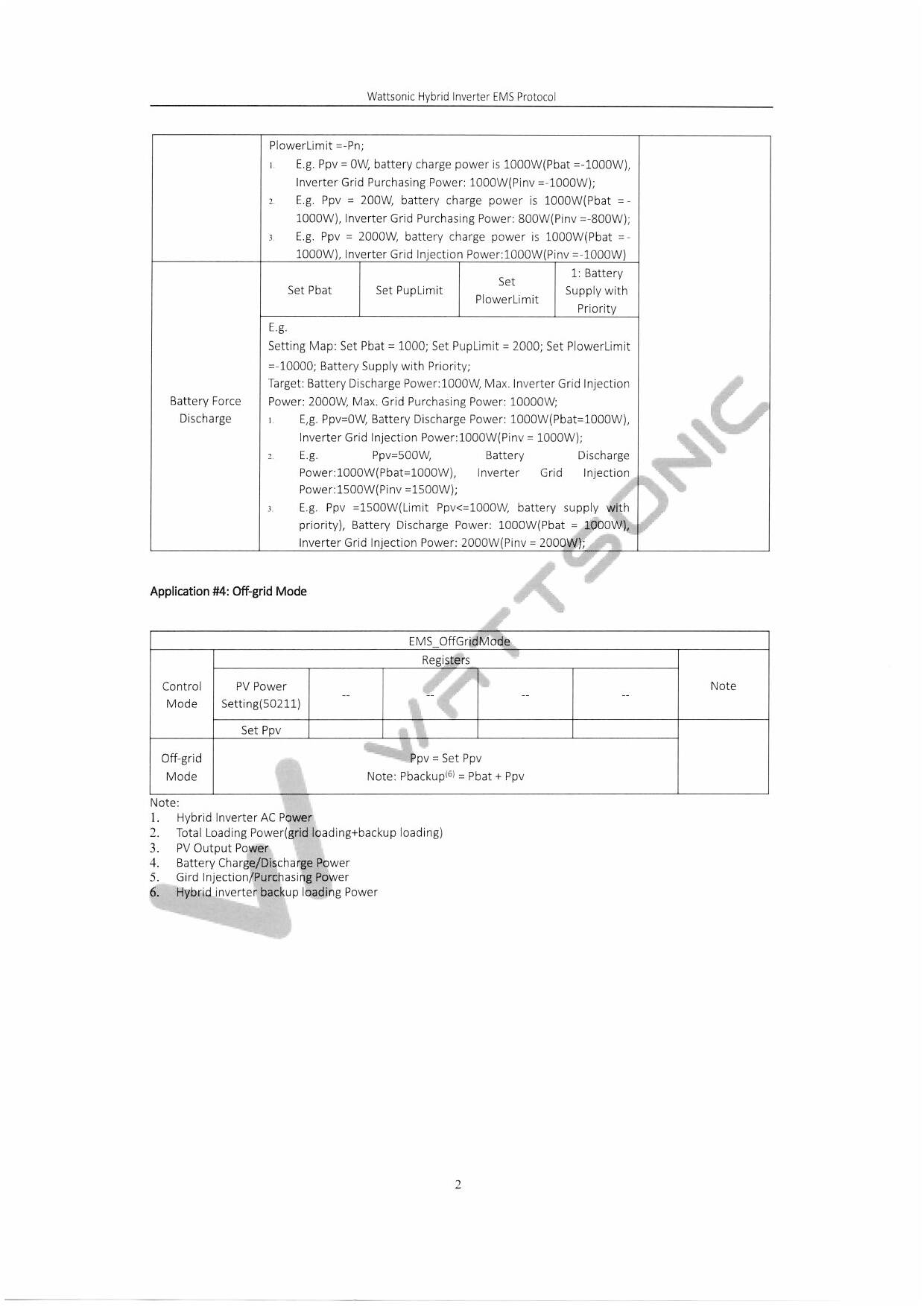

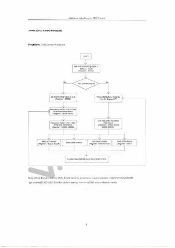

I have also attached what I think is the relevant documentation.

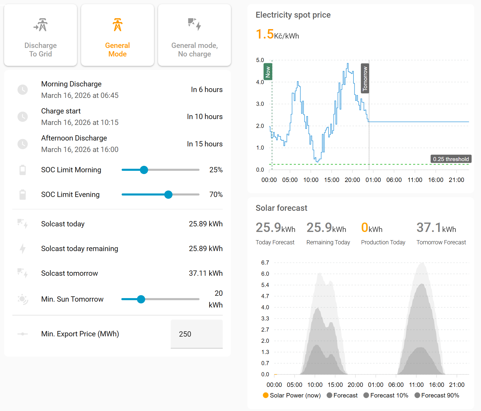

I’ve been trying to configure the inverter (Wattsonic G3) for the morning hours. The idea is to delay charging the battery until the cheapest hours (around noon).
From my experiments, setting (ECO, CHARGE, PowerLimit: 0) works well as long as there is enough energy from PV. However, if PV production is not sufficient (ie very early morning and someone boils water for tea), the house draws energy from the grid instead of the battery.
What am I missing? How can I prevent charging the battery while allow to draw energy from it if needed?
By the way, during my experiments, I have hard times getting inverter back to General mode. I would expect that in General Mode it ignores all ECO settings, but it seems these settings still have some influence. At one point, the inverter was in clearly in General Mode for longer period of time, let’s say 10minutes, yet it neither charged nor discharged the battery—it simply ignored it. There were no errors.
Even switching modes using the Wattsonic app did not fix the issue. I tried various settings to resolve it, so I’m not exactly sure what fixed it in the end. It might have been either deactivating the time period or changing the charge mode (PV vs. PV+Grid).
Could you confirm whether such a dependency exists?
edit: FW version of my inverter is v2 (As far as I read some newer versions are less unstable) However I found article (in Czech) that with new firmwares new ToU modes are available. It also means that current modbus integration does not support new features. Is there any chance that the author take a look on that?
The article contains the link to PDF describing all new sub-modes and extended ToU.
Seems no Wattsonic user optimizes ROI by shifting charging time to the cheapest hours?
If any, I found the solution, and created a pull request to the integration GitHub.
It brings two significant improvements:
  • adds two missing registers allowing to limit the current for battery charge and discharge. Specifically, it makes possible to utilize the General mode with charging disabled.
  • extends support for new modes introduced in the v3 firmware of Gen3 inverters. These are Feed-in , Peak shift , and TuO. Note that the Feed-in mode behaves exactly like General with battery charge disabled.
For other changes, please refer to the PR description

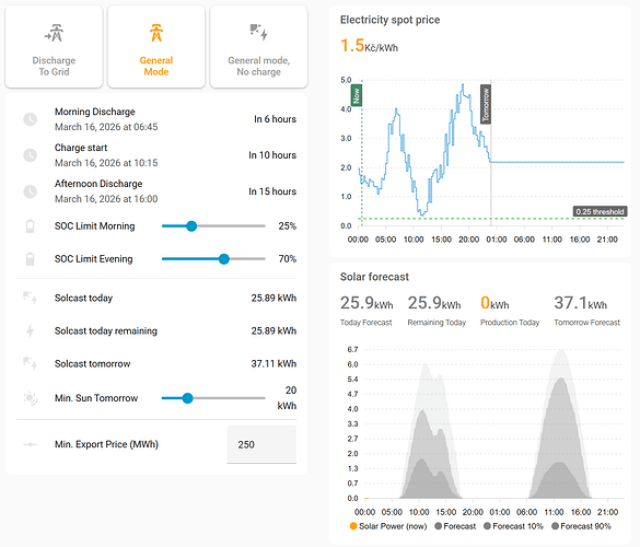

BTW, I wrote very simple yet effective automation(s), for ROI optimization by charging and discharging the battery with the best timing. I should publish that within a few days. Sneak-peek:
