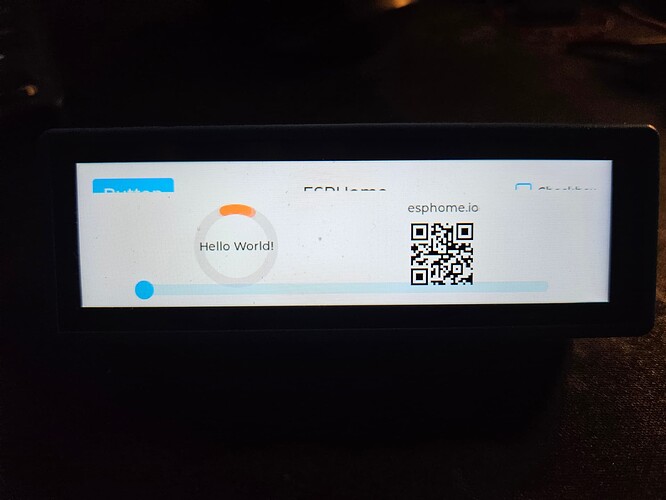

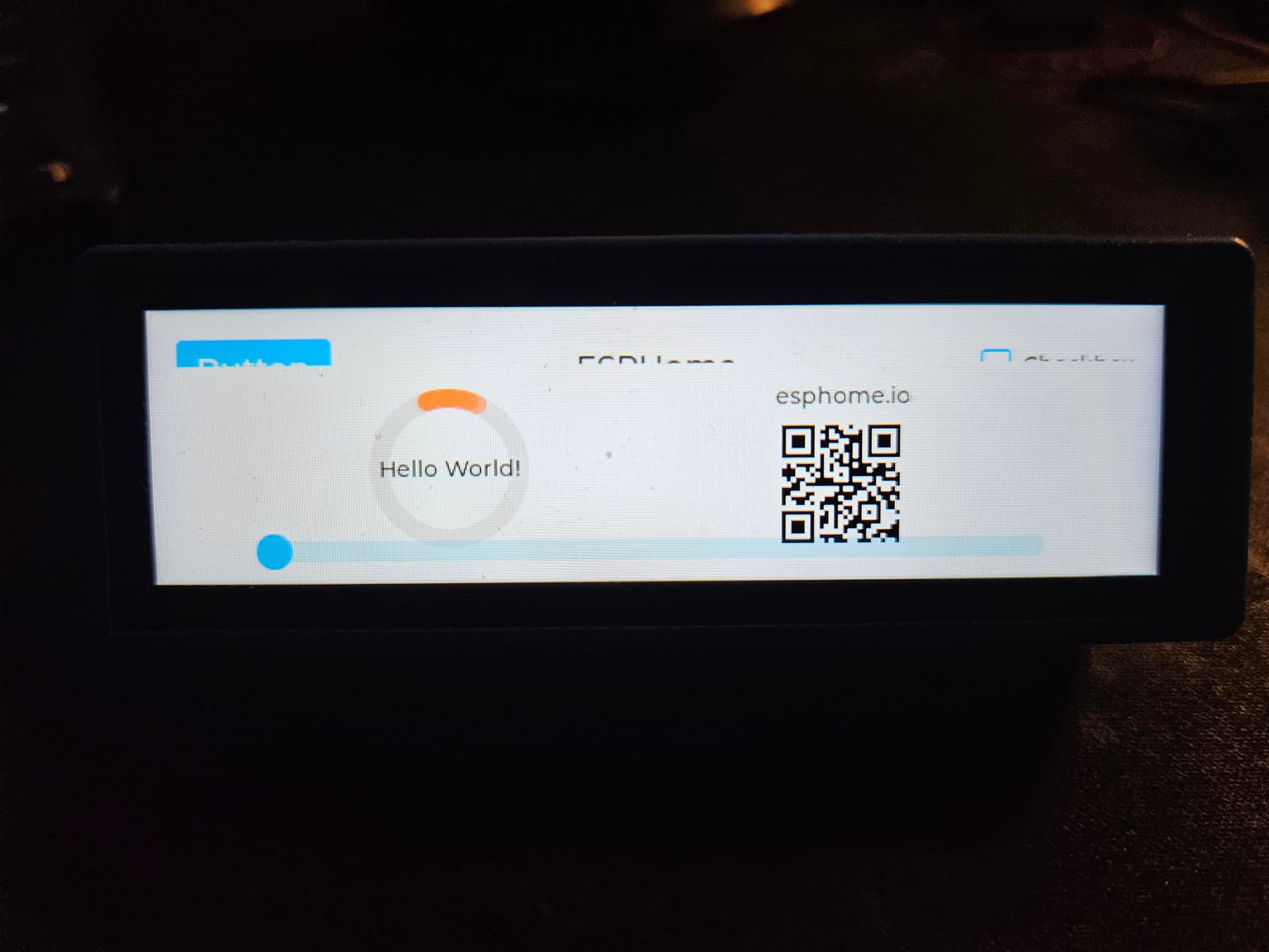

Waveshare 3.49 and mipi_spi
You’ll need to compile with the dev version, there are other changes merged.
I updated the PR so should fix that.
external_components:
  - source: github://pr#11680
    components: [lvgl, const]
    refresh: 1h
sorry was at work, but tested now and seem you fixed the problem :slight_smile:
compiled with normal ESPHome 2025.10.3.
you better be the one to close as solution, last time i did was too early :wink:
thanks for sticking with this issue :+1:
sidenote, i used the same display model as before, not the one in your example:
