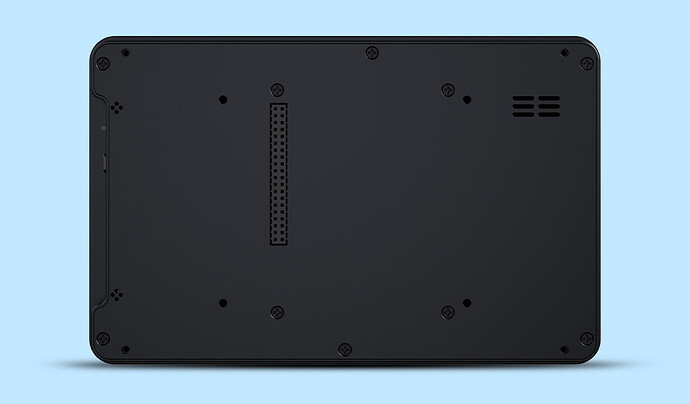

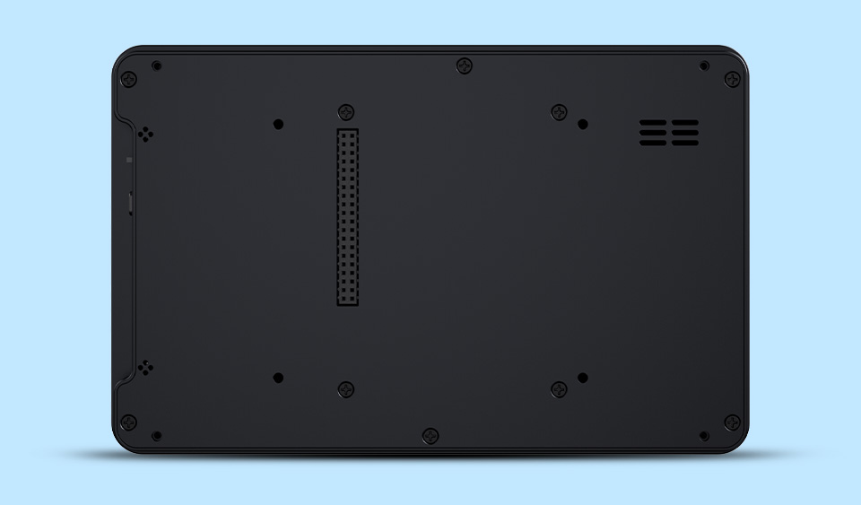

Do you have the Waveshare ESP32-P4-WIFI6-Touch-LCD-7 or the Waveshare ESP32-P4-WIFI6-Touch-LCD-7B?
Can you post a picture of the back of your screen?
Here you can find the features: https://it.aliexpress.com/item/1005010759059321.html?spm=a2g0o.order_list.order_list_main.139.6e073696nG6QAp&gatewayAdapt=glo2ita
I have made some changes. Can you download the latest from here?
Also make sure you build this file.
it works now, thanks!
