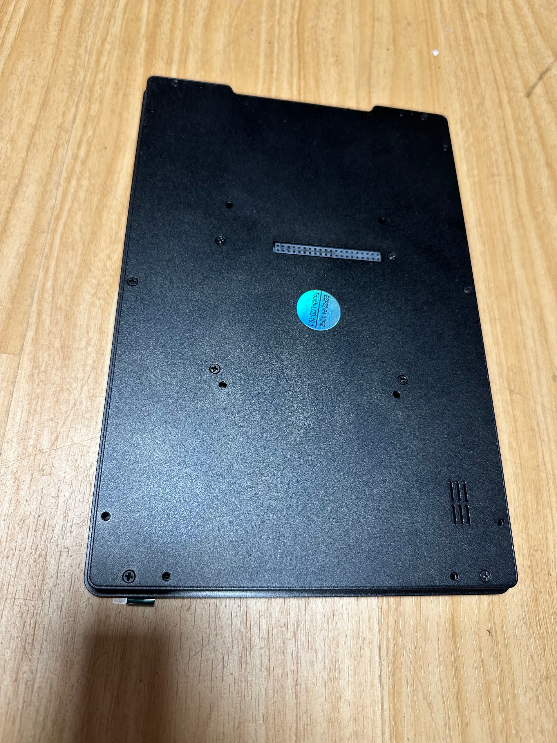

There are not any good pictures of the back of this screen online. You can see it’s very flat. The back is an aluminum plate that matches the case.

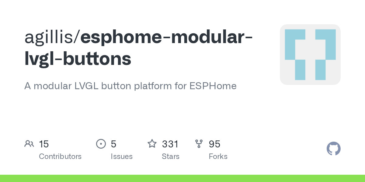

Got it working on esphome-modular-lvgl-buttons, but I chewed up a lot of claude tokens in the process, and it's super slow when rendering the captured image to screen (not all that useful, just thought it would be cool to do selfies or show feedback for some kind of remote authentication).
Also, Waveshare defaulted the display & camera to portrait, which makes zero sense for its position (center of the long side), so getting a decent image when mounting the unit landscape is tricky.

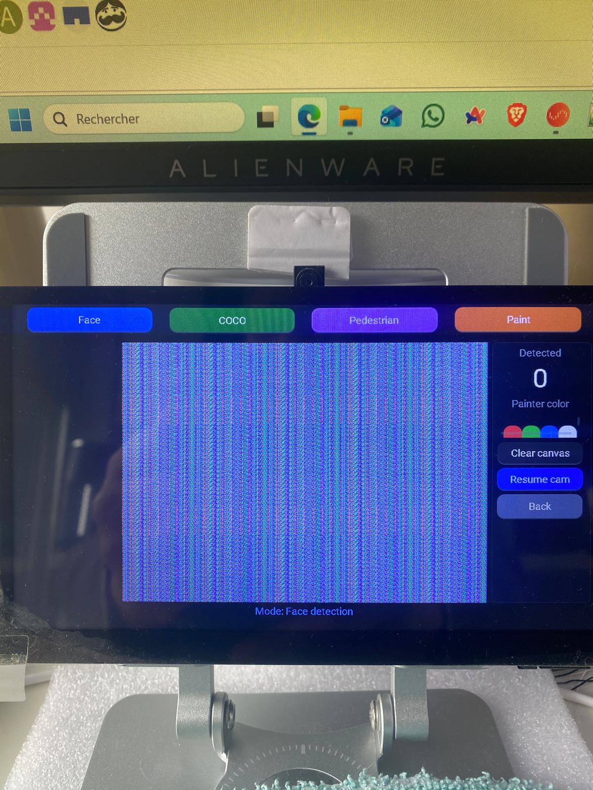

I'm in landscape mode, and the frame rate can exceed 26 fps on EPShome depending on the lighting.
However, I'm not using esphome-modular-lvgl-buttons; my ESP32P4 is an ESP32-P4-WIFI6-Touch-LCD-7B-C, which has the same functionality as yours except for the resolution. I'm using the master version of lvgl 9.5 available in my repository. The PPA and PPA rotation image work, as does Thors VG, the most complete configuration I've been able to create for the camera. I'm using esp_video and esp_cam_sensor, which work on EPShome. Face detection, Predestrian, and Yolov11 are also working.

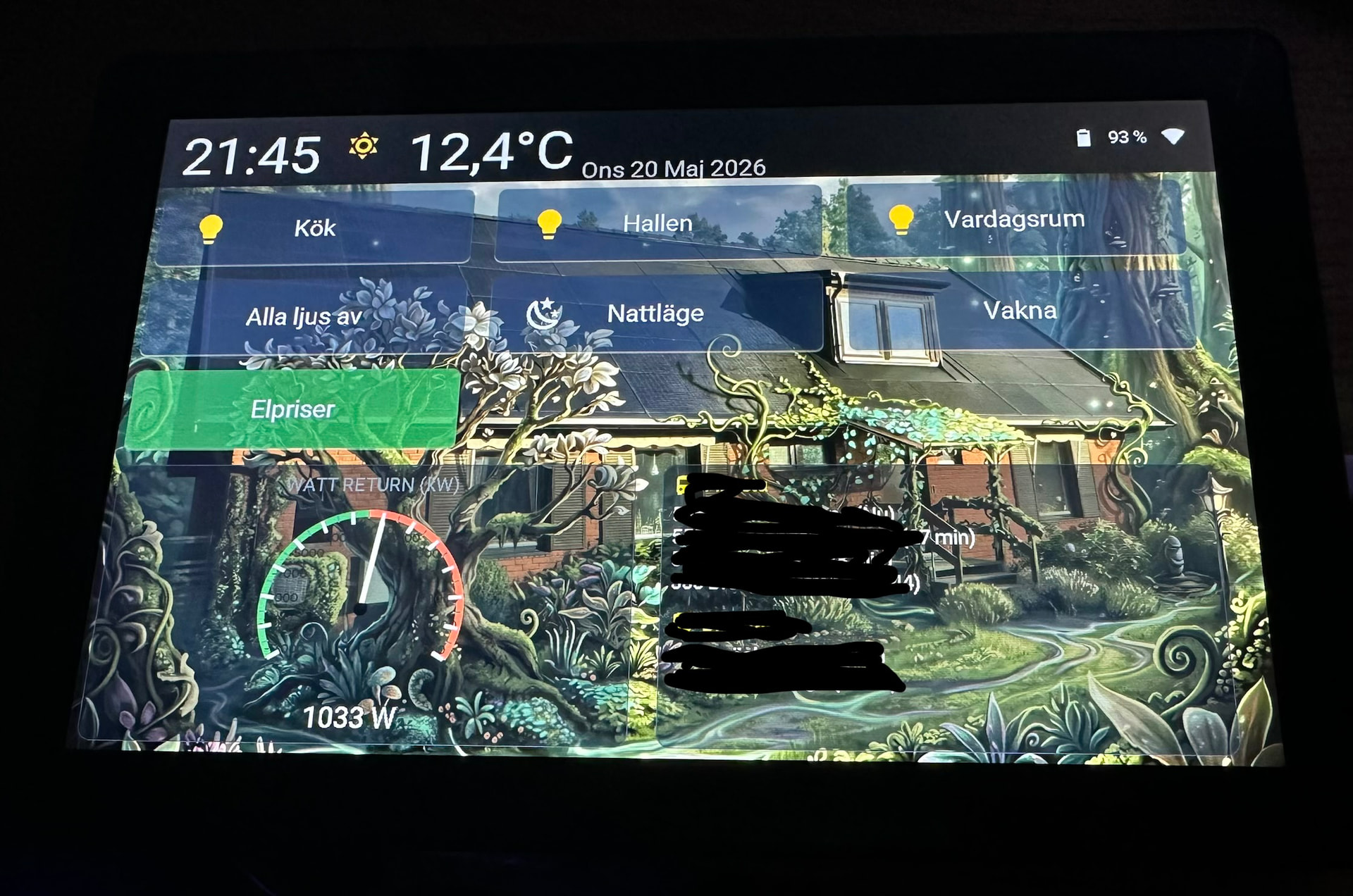

I have been testing a bit with the 10 inch screen and this is how far I got.
