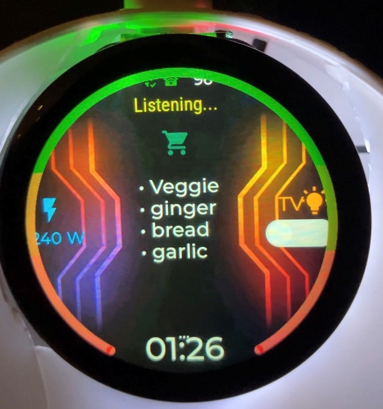

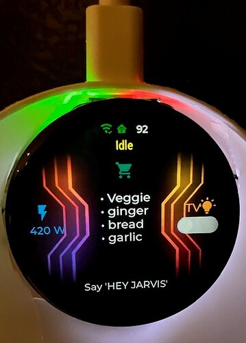

I purchased this little round screen a few month ago, for it’s good resolution compared to it’s size, also able to setup Voice assistant on it.
I have setup the display with LVGL for a while, but until recently I managed to create a component gluing espressif/esp_lcd_touch_spd2010 and espressif/esp_lcd_touch driver to ESPhome and feed the touch data back to lvgl under ESP-IDF framework. So you don’t need to do the hard work again.
It’s a perfect size for a fridge magnet, showing shopping list and some other staff on it.
Here is the github repo component files and yaml config, if anyone interested.
