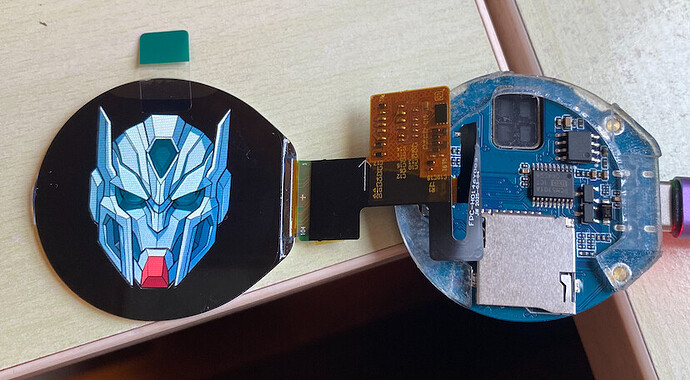

How about your progress for the touch? I make a custom component to get the touch point information from SPD2010 touch controller and send the data to LVGL by using LVGL callback function. it works pretty good. I also tried to make an external component which is expected to be a component for touchscreen but fail. the way of custom component is not formal solution. only external component can be the PR. Hopefully, you have good progress to make it.
