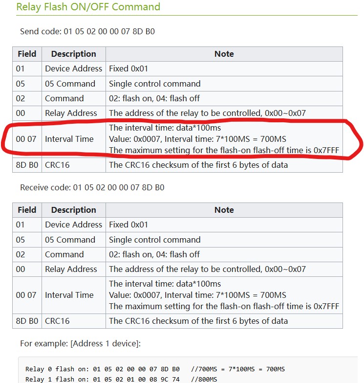

But when I look to the manual of waveshare I see it shold be possible to control a relay so it flashes with a interval time which you can define. For example a on flash during 0,7seconds or 0,5 seconds.
See here: https://www.waveshare.com/wiki/Modbus_POE_ETH_Relay_(B)#Relay_Flash_ON.2FOFF_Command
But how do I translate that command in my .yaml file please?
For example for CH1 to flash on for 700ms: 01 05 02 00 00 07 8D B0
How do I give in the .yaml file to adres 512 the interval time 00 07 please?
