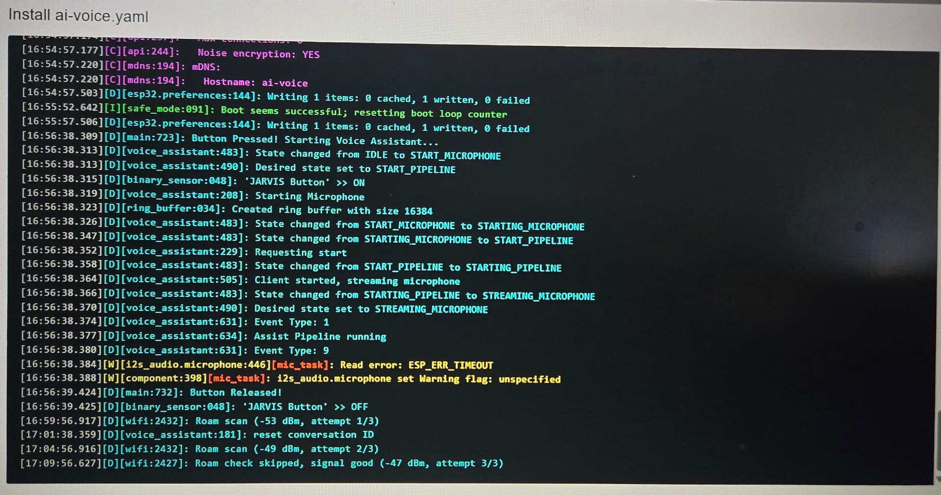

it will compile but I for the life of me can not get the mic to work i tried asking AI and Claude admitted it had no idea either, the writing was a bear with new 6.3.3 syntax change tried to use the native drivers a. Any have any luck or tips and tricks? I know they feed from the same bus but the new symtax is not allowing in ESP home to write a double path, if you look at the above we tried the “repo” that in but lost working sound timing

same problem here. been struggling to figure out how to fix it. I also get the same errors with GitHub - MarcoFre/ESP32-S3-AI-Smart-Speaker: Home Assistant - Voice Assistant for Waveshare ESP32-S3 AI Smart Speaker · GitHub
