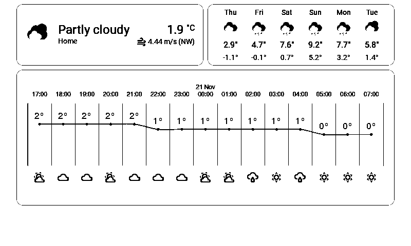

Hi, I’m looking at Way to create a dashboard with MINIMUM amount of padding between cards and object. I’m using kiosk mode to produce bitmaps for e-ink display where every pixel comes at premium.
Below is an example:
As you can see there is an ample space wasted on the sides, at the top, between the cards …
