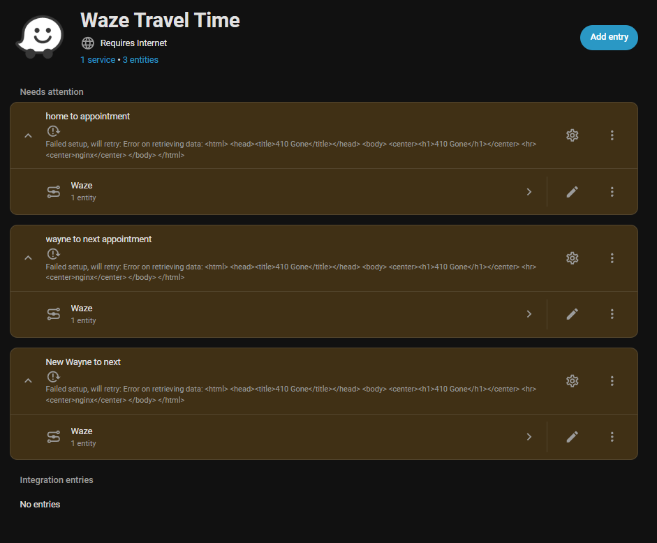

Confirmed Waze changed the API so any release prior to 2025.12 will have the issue a couple of reference if you are up for a read :slight_smile:
Anyone else having issues with the Waze Travel Time integration lately? : r/homeassistant
Waze routing endpoint now returns HTTP 410 Gone for all requests · Issue #48 · eifinger/pywaze

I am on 2025.12.1 and I can’t add the integration. The UI just says “failed to connect” whenever I try.

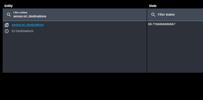

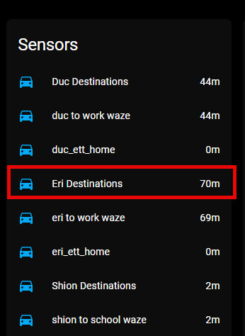

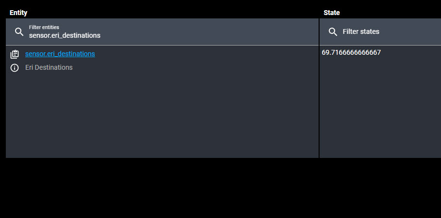

Do you guys have issue where it started to show long digits after some old core updates?? Mine started to do that I think in the .9 core updates and I have no clue how to fix it. Waze displays correctly.
While in the frontend and develop tools, it is showing this.
