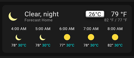

Do you know if there’s a way to make the hourly also C and F?
Thanks!
Yes but it would require:
  • Adding an hourly weather template sensor
  • Isolating the hour temp element in the card
What weather integration are you using ( Accuweather, Meteorologisk institutt )?
It would look something like this :arrow_down:
Here is one method using data from the Meteorologisk institutt weather intergration.
show_current: true
show_forecast: true
type: weather-forecast
entity: weather.forecast_home
forecast_type: hourly
secondary_info_attribute: wind_speed
card_mod:
  style: |
    .temp-attribute .temp::before {
      content: "{{ ((state_attr('weather.forecast_home','temperature')-32)/(9/5))| round(0)}}°C /";
      margin-left: -20px !important;
    .forecast div.temp:nth-child(3){
      font-size: 13px;
    .forecast>div:nth-child(1)>div:nth-child(3)::after{
      content: "/ {{ ((state_attr('sensor.weather_hourly','forecast')[0]['temperature']-32)/(9/5))| round(0)}}°C";
    .forecast>div:nth-child(2)>div:nth-child(3)::after{
      content: "/ {{ ((state_attr('sensor.weather_hourly','forecast')[1]['temperature']-32)/(9/5))| round(0)}}°C";
    .forecast>div:nth-child(3)>div:nth-child(3)::after{
      content: "/ {{ ((state_attr('sensor.weather_hourly','forecast')[2]['temperature']-32)/(9/5))| round(0)}}°C";
    .forecast>div:nth-child(4)>div:nth-child(3)::after{
      content: "/ {{ ((state_attr('sensor.weather_hourly','forecast')[3]['temperature']-32)/(9/5))| round(0)}}°C";
    .forecast>div:nth-child(5)>div:nth-child(3)::after{
      content: "/ {{ ((state_attr('sensor.weather_hourly','forecast')[4]['temperature']-32)/(9/5))| round(0)}}°C";
To get hourly data you’ll need to create a template sensor that contains the hourly forecast.
A Template Example
  • You can define the sensor’s state to your liking. The attributes define the hourly data.
  • The datetime: attribute will show the date/time in UTC and most likely will not match your displayed system date/time .

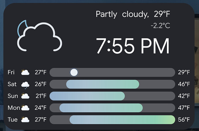

Yo! Sharing a card-mod method that accomplishes thisIn case you’re using pkissling’s clock-weather-card and come across this post:
Step 1 – Create sensor that stores calculated temp in °C
Go to Helpers > Create > Template > Sensor
Name it “secondary weather temperature”
Use this template, be sure to sub in your weather entity in the < carrots >.
{% set fahrenheit = state_attr('weather.thegoonies', 'temperature') | float %}
{% if fahrenheit is defined and fahrenheit != 0 %}
{{ ((fahrenheit - 32) * 5 / 9) | round(1) }}
{% else %}
N/A
{% endif %}
Step 2 – Inject subtitle with your °C value using card-mod
Confirm that this template renders correctly in developer tools > templating:
{{ states('sensor.secondary_weather_temperature') }}°{{ 'F' if
is_state_attr('weather.<< your entity here >>', 'temperature_unit', '°C') else 'C' }}
The resulting sensor should output your current temperature in c.
Append your lovelace card with this modification, substituting your correct entities:
card_mod:
  style: |
    :host {
      --dual-temp: "{{ states('sensor.secondary_weather_temperature') }}°{{ 'F' if is_state_attr('weather.< your entity here >', 'temperature_unit', '°C') else 'C' }}";
    clock-weather-card-today-right-wrap-top:after {
      content: var(--dual-temp);
      display: block;
If done correctly, your card should now show both temps!
Note: It’s also possible to do this for each of the forecast rows though I personally didn’t like how it looked; too much of an eyechart and my family just wanted the at-a-glance current conversion.
