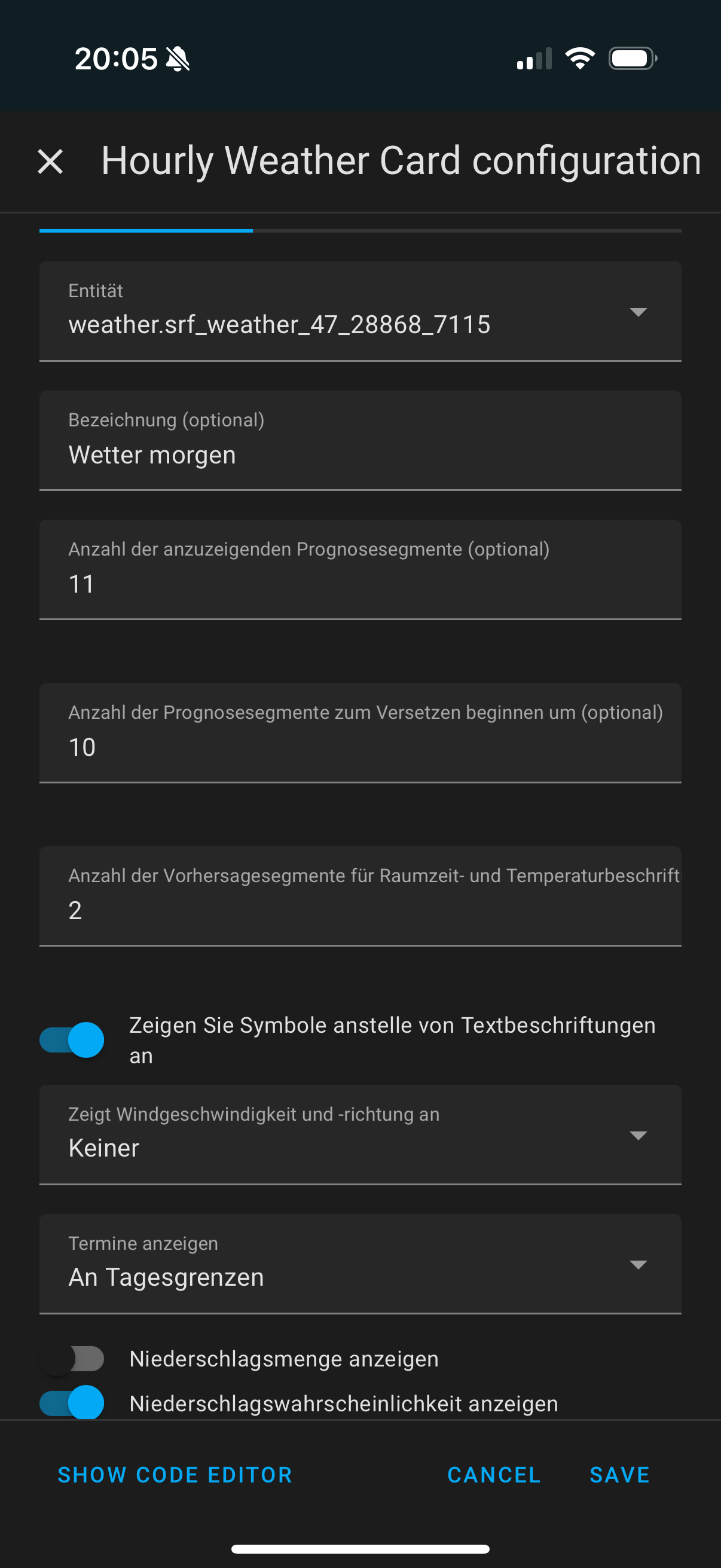

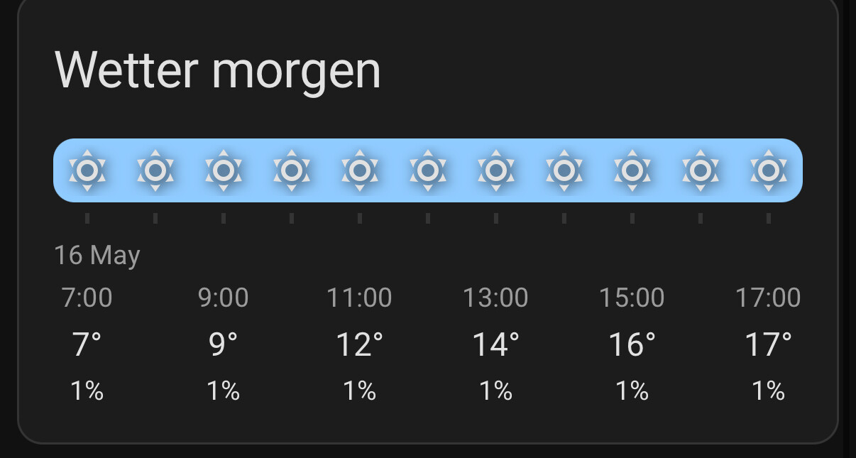

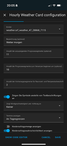

thanks for your thoughts. I’ve went a different route, using Hourly weather Card
This config
gives me this
card on my NS-Panel. Which is close enough to what I need.
