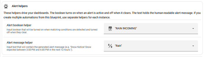

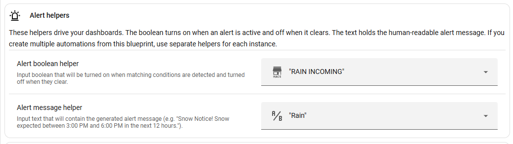

Sorry for the silly question as i am newB to HA stuff.
What have to put in Alert boolean helper, anything specific or just what ever is easy for me to understand what is incoming?
I tried to Run and test the automation, but still do not get Phone alert, any way to test the alert or just wait for the next rain :).
I cant seem to get this to work… What else needs to happen with the helpers?
