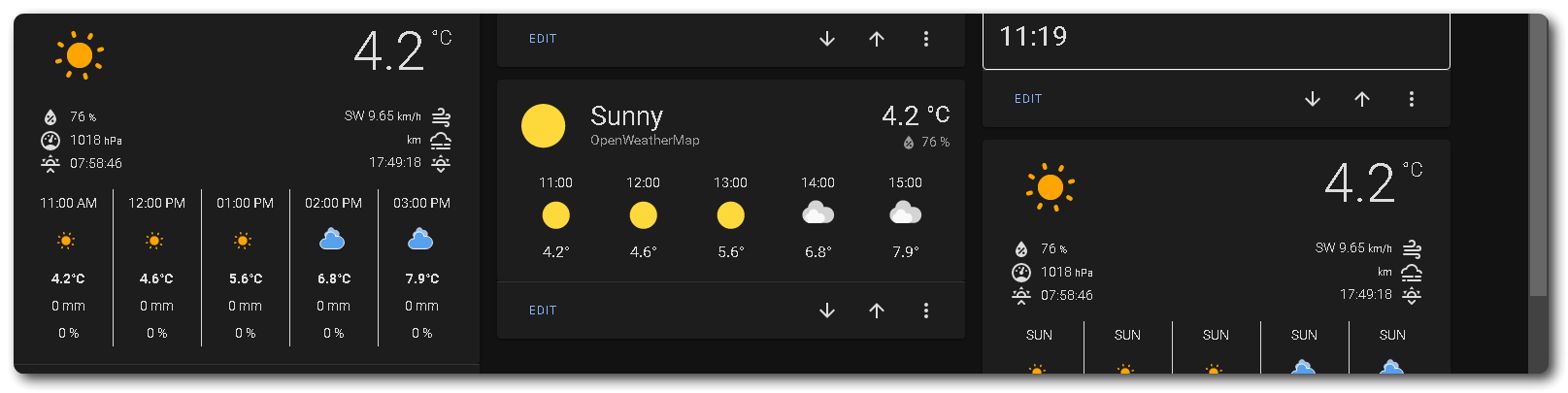

should look like this i’d done with FHEM and data from DWD Opendata (Deutscher WetterDienst)
A daily Forecast 4-7 Days , 4 Times a day , 8, 12, 16,20

but what i want is this, done with FHEM/FTUI, but found no solution
@RKsHAss Thanks for the reply. The screen shots are exactly what I am trying and hoping to achieve but I am still lost without YAML dashboard card code.

at least i’m using the Deutscher Wetter Dienst but for you, you may start with https://openweathermap.org/
Create a free account and get a API Key.
and then start with the - custom weather card -
insert this weather card
edit this card , show code editor
type: custom:weather-card
entity: weather.openweathermap
number_of_forecasts: '5'
forecast: false
hourly_forecast: false
details: false
than insert a secon weather card
and edit - show code editor
forecast: true
hourly_forecast: true
current: false
details: false
should look look this
