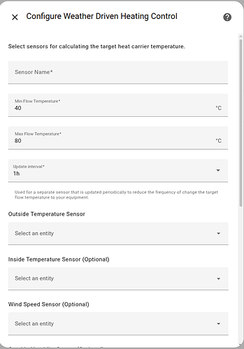

I’d like to introduce my integration, which calculates the required heating system supply temperature based on weather conditions. To set it up, you need to specify a heating curve number (from 1 to 200) and select your weather sensors (or a weather service provider’s sensors). You also have flexible control over the shape of the heating curve by adjusting the exponent parameters.

Settings screenshot:

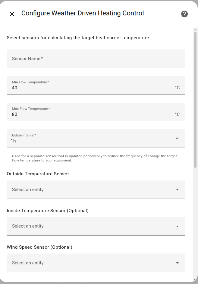

Hello. This no longer seems to work: the output flow temperatures seems to be stuck at 40°C
Hello! Change the settings. The default range is 40-80 degrees. Set them according to your heater’s specifications.
