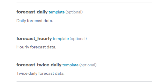

If you look at the configuration variables schema, you will see that daily, hourly, and twice daily forecast types are all supported.
