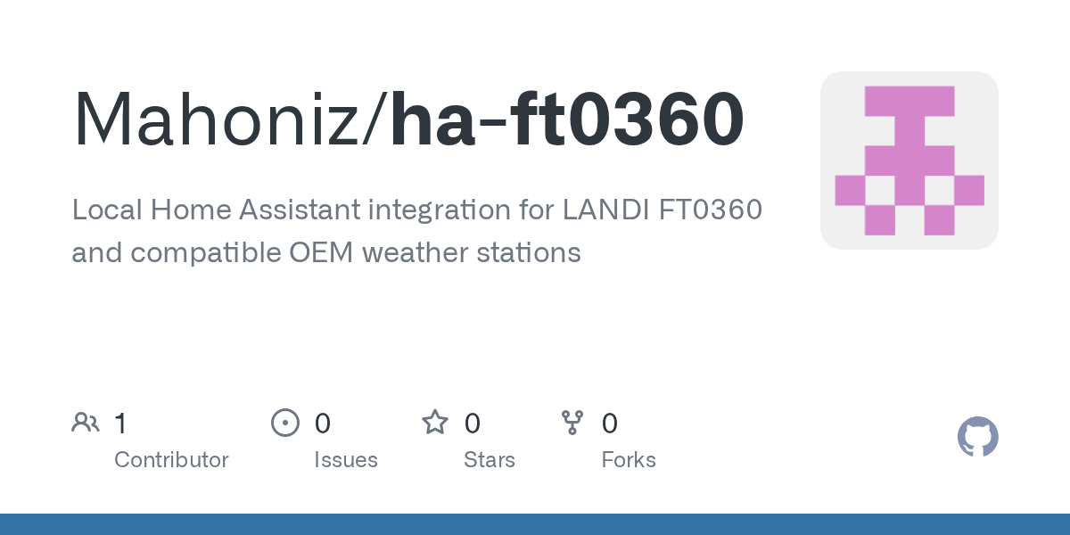

I wrote an implementation of it as I want fully local data and not fetched from wunderground.
You can check it out here: GitHub - DeadMonkey428/ha_ft0360 · GitHub

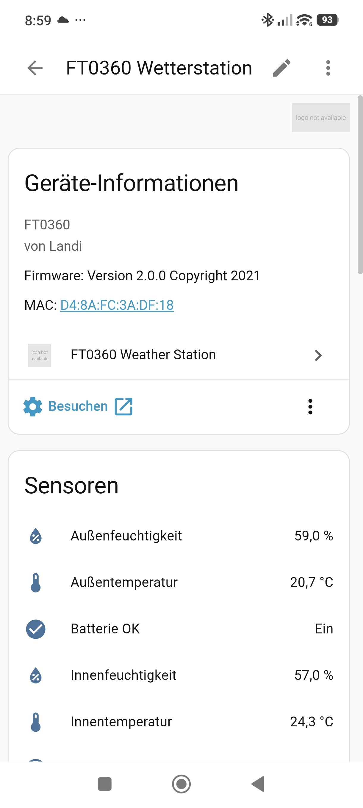

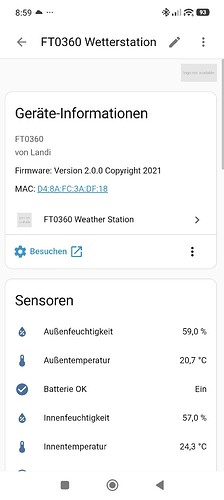

Thank you @Deadcow for sharing the original local FT0360 integration — it was very helpful and confirmed that this station can be used fully locally in Home Assistant.
I have since published an additional local integration for the LANDI FT0360 and compatible OEM weather stations:
It reads the station directly from its local HTTP endpoint (/client?command=record), without Weathercloud, Wunderground, or another cloud service.
LANDI sells this model in Switzerland, but the console uses the FT0360 protocol and may also be sold internationally under other OEM brands. The integration provides temperature, humidity, pressure, wind, rain, solar radiation, UV, battery status, and diagnostics.
During setup, it is possible to choose indoor only, outdoor only, or both. This allows the same station to be added twice: the indoor device can then be assigned to a Home Assistant area, while the outdoor device stays independent.
The integration is currently available through HACS as a custom repository. Its submission to the official HACS catalog is pending.
