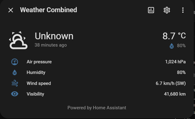

I’m trying to create a Weather template but for some reason it will not accept my condition.
This is my template
template:
  - weather:
      - name: Weather Combined
        unique_id: weather_combined
        apparent_temperature: >
          {{ states('sensor.weather_current_feels_like_temperature') }}
        cloud_coverage: >
          {{ states('sensor.weather_current_cloud_cover') }}
        condition: >
          {{ states('sensor.weather_current_conditions') }}

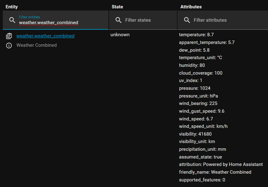

It creates the Weather entity but not condition and hence its state is unknown.
Here is some supporting ‘evidence’…

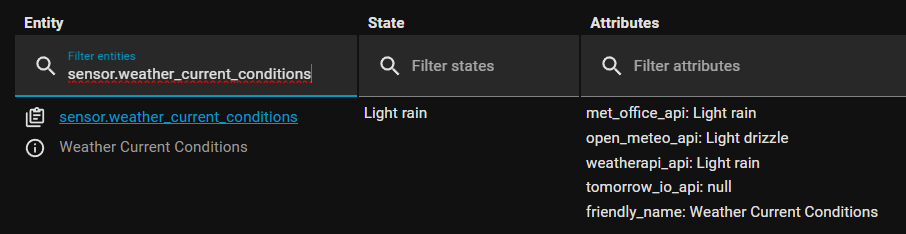

First, sensor.weather_current_conditions to prove it is valid
Here is the weather entity itself:
Note that everything else is populated because…
…on a dashboard I do not get all the data.
But in the dev tools clicking the ‘i’ icon I get some extra data in the more info dialog

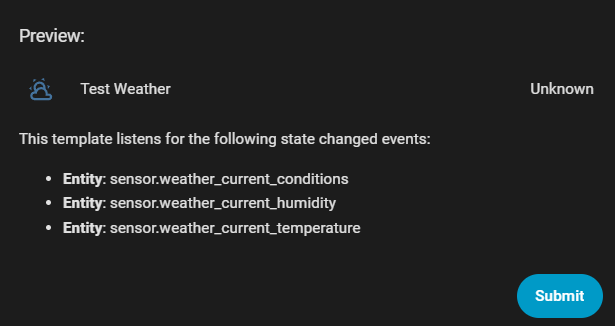

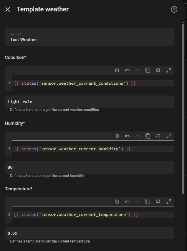

And finally here is evidence that when creating it in the UI it seems to be happy…
(here is the preview at the bottom)
… but it still isn’t

I think it may be down to the fact that “Light rain” is not one of the standard conditions.
yeah I did consider that but for the life of me I could not find a list of the standard conditions.

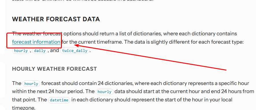

You mean like the entire Weather Forecast Data section, where the structure of each type is described?
I mean exactly that.

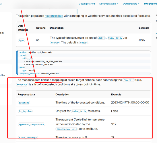

Show me where it tells you the structure of the data that is read into the template?
All done :wink:

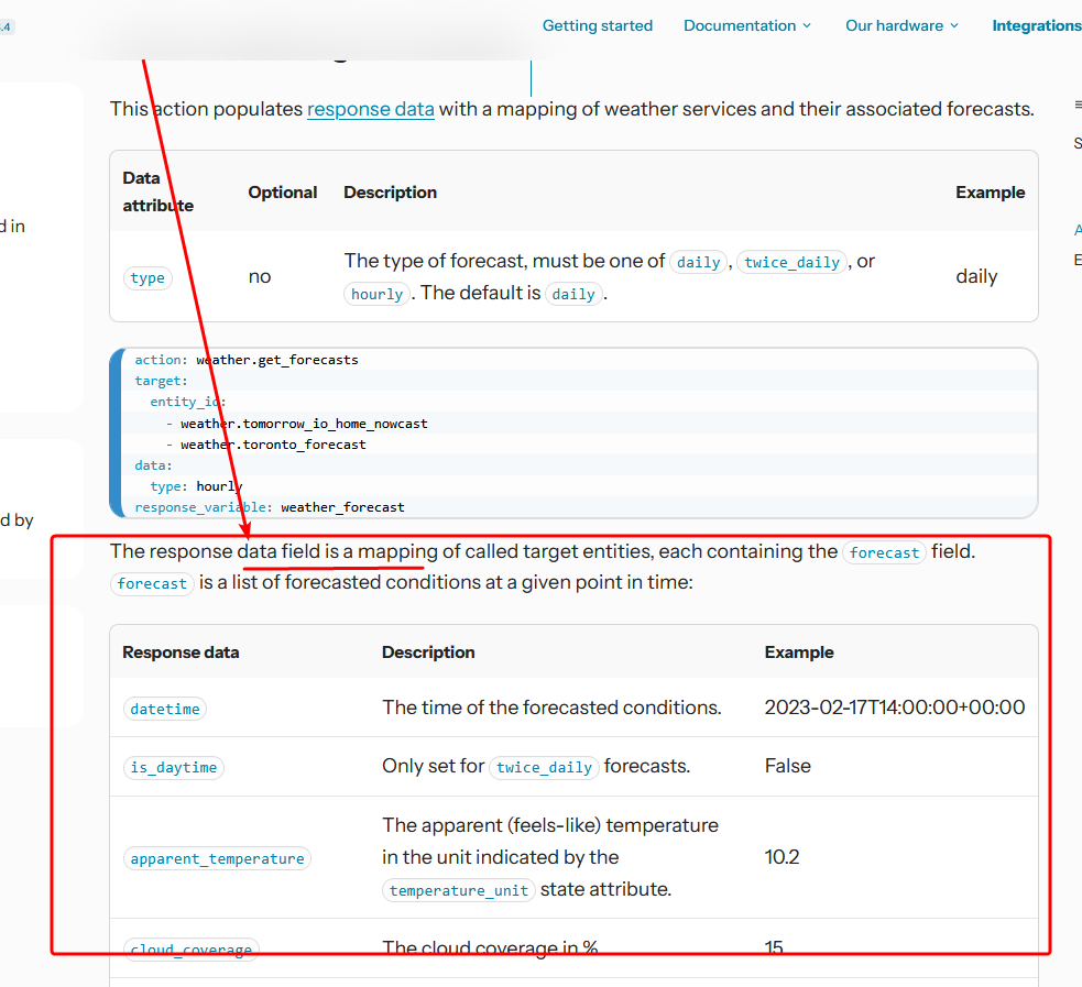

Pulled straight from the docs
Tells you it needs to be a dictionary in the main template docs with a link to all dictionary values.
And the link references “mapping” which is another way to describe a dictionary, and shows all the values.
I’m not going to replicate that information in the template documentation when a link to it works. It just seems like you didn’t look at the link.
