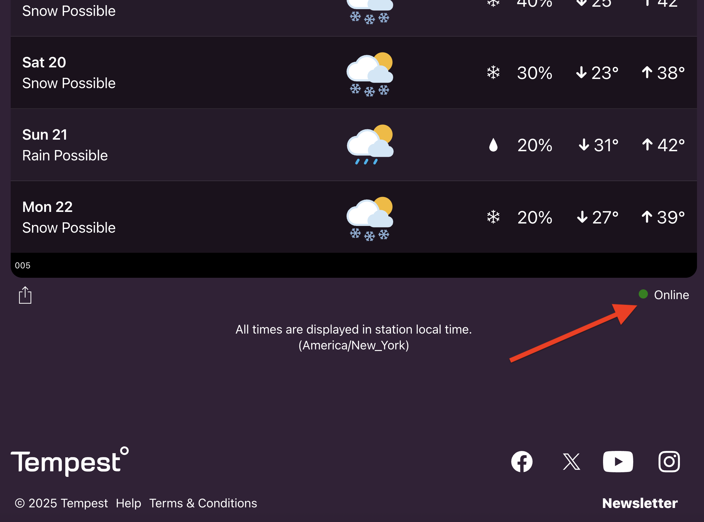

If you want to dig deeper, there’s a “hidden” diagnostics screen on the Tempest station’s web site. Just click/tap on the green “online” status indicator on the bottom of the screen, and it will bring up a screen that includes sensor status that should include detecting a lightning disturber nearby:
Ah, thank you guys. I did not know that the lightning data was filtered, and that the local pull of lightning data (through the integration) is not filtered. It makes sense to me. I guess the filtering happens in the cloud and not the hub then?
As far as the diagnostic info (thank you for the link), mine has no data relating to lightning (or disturbers) visible. Taking a stab in the dark, I’m wondering if solar panel arrays could trigger these false readings? I have panels as do most the homes around me, have no placement options to get around this.
