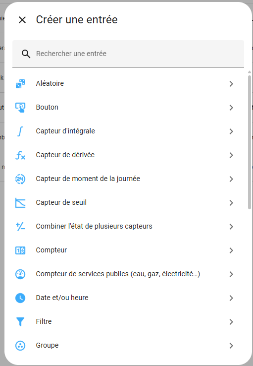

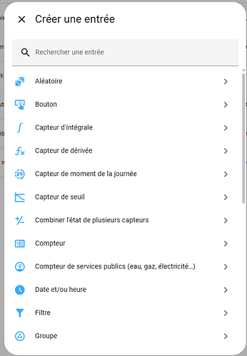

So If I understand correctly, I need to create an helper “triggered image” …can’t find this on my HA :
Where can I find this ?
Then purpose is to use that helper entoty in picture entity card, is this correct ??
Many thanks !!
YAML only. See: Template - Home Assistant
