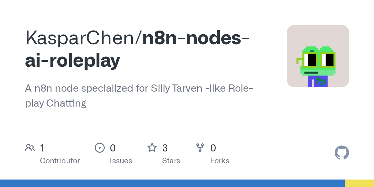

Have you ever used Silly Tavern? The character AI type platform where you have character cards and can have multiple characters in a roleplay type conversation?

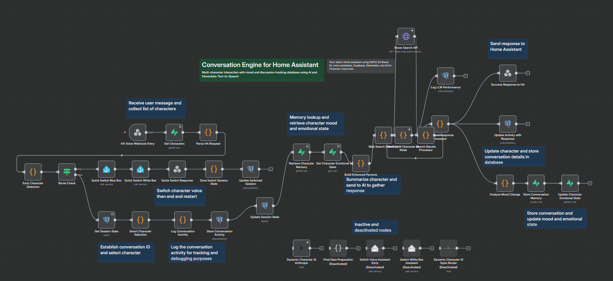

I was checking out this community node for n8n: Roleplay AI and trying to mod your Webhook Conversation by adding some logic in the middle of the workflow. I got something working but through my vibe coding with Claude I kept running into some obstacles passing back the “output” to Home Assistant.
  • I noticed I have to pass back the “output” on it’s own or else I get a “Unable to get response” error message on the Home Assistant side.
  • If streaming=true for the Webhook node, Claude was unable to just place a simple “Respond to Webhook” node at the end to pass “output” as something related to how the Agent node handles the streaming + “output” Claude was unable to replicate.
  • The way I have it now is the Roleplay AI node sets all this character scenario info, character details, etc. and contacts Anthropic AI model within the node —> Then at the end of the workflow I have to have the end-Agent which I have to connect an OpenAI chat model too so it’s kinda double-hitting AI’s during the workflow when all I really wanted was to pass back the “streaming” “output” conversation response if that makes sense.

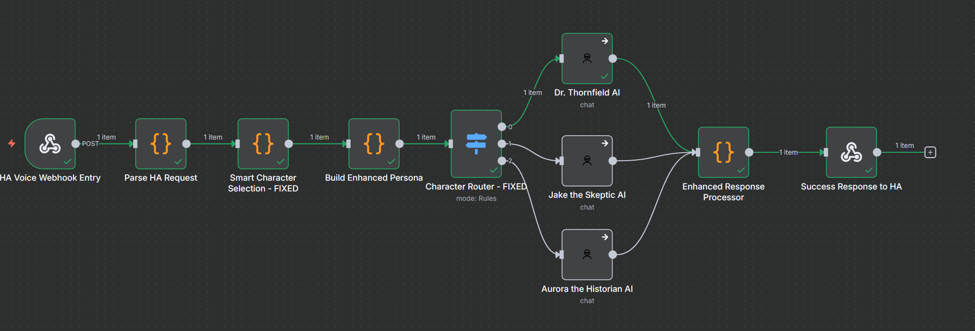

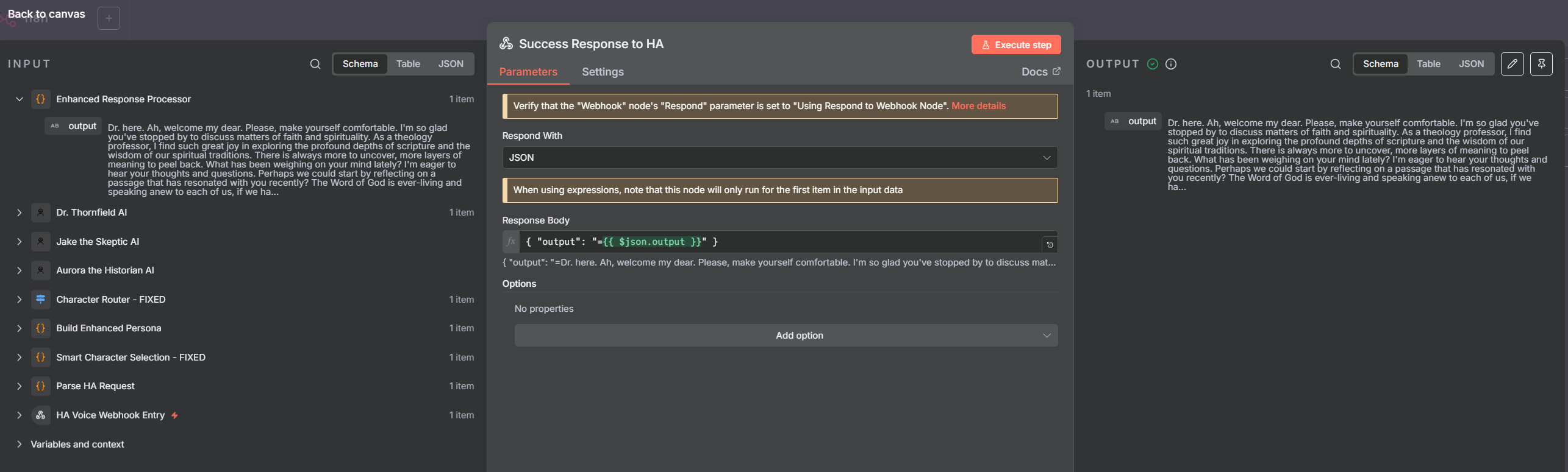

Thanks, I re-read the readme and I’m just stuck.
Streaming is enabled.
I changed the first Webhook entry node setting to "Use “Respond to Webhook” node for the response.
My final node is only sending the the JSON of the “output”.
I hear “Unable to get a response” coming out of my speakers as the Home Assistant error always shows:
"2025-09-04 10:41:54.647 ERROR (MainThread) [homeassistant.components.conversation.util] Last content in chat log is not an AssistantContent: UserContent(role='user', content='Professor.', attachments=None). This could be due to the model not returning a valid response
Claude AI keeps telling me is:
The Agent node in the original workflow is simple - it takes a query, processes it with AI, and returns just the text response. Your workflow should do exactly the same thing but without the Agent node since you don’t want to use AI twice in your workflow: AI character processing → clean text response → single webhook response.
This eliminates all the extra data passing and gives Home Assistant exactly what it expects - just the spoken response text.
I haven’t tried disabling “Streaming” in your HA integration yet (perhaps that would work?).
I really appreciate your help Lennard!
When you use an Agent node in n8n with response streaming enabled, instead of getting a response containing this:
  "output": "The output generated by the LLM."
you will get multiple responses that look like this:
{"type": "item", "content": "First part of the response"}
// some time passes
{"type": "item", "content": " continues here"}
// some time passes
{"type": "item", "content": " and more content"}
// some time passes
{"type": "end"}
This is so the TTS audio can start playing as soon as the first parts of the response are generated and not only after the complete response is generated and returned.
In your workflow you are not using an Agent node with streaming enabled.
Your custom nodes return the response in the first format (the one with the “output” field). The webhook-conversation integration will only understand this output if you disable response streaming in the integration config options.
If you want response streaming, you will need to return multiple response chunks like I described. How this works on the protocol/network level in case you want to implement this manually I can’t tell you.
Ahhh I understand, so with the non-streaming approach it will accept the one output but for streaming it needs to be returned in chunks. Got it, I should be able to truncate and split the response manually. Thanks Lennard I’ll give that a shot.
As for memory options, did you happen to test any RAG type database storage with your development and testing of the integration?
PS: I got the non-streaming version with multiple characters fully working, thanks! Now I can mess around with experimenting with some multi-character interactions within a single conversation prompt from me and me calling out a character to speak with.
That’s great!
I only tried the simple memory node, but I don’t think that the memory storage has anything to do with how the workflow is triggered, so you should be able to use any kind of memory.

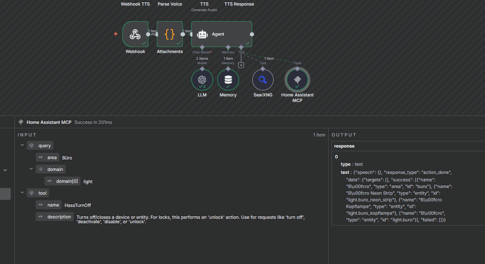

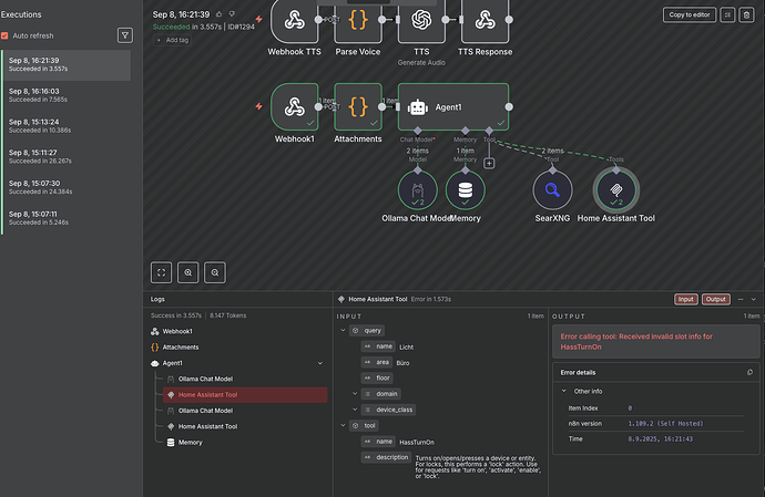

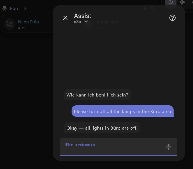

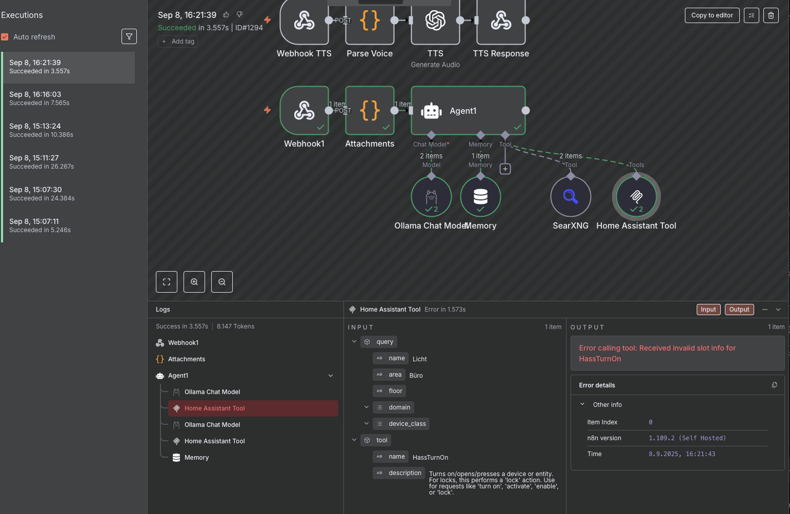

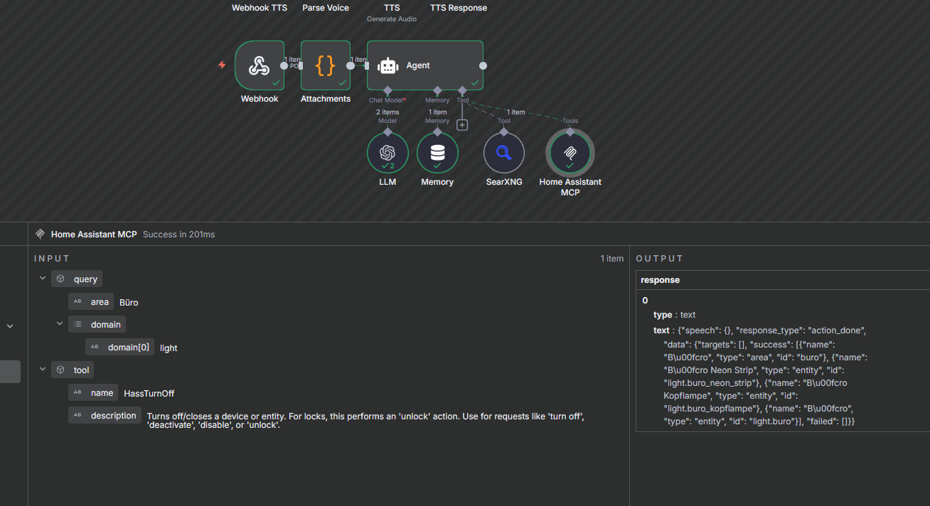

Hey hey everyone. I have this great integration running, but running into issues workflow wise, to control actually my smarthome in HA. Right now my workflow follow the latest example from the git. As model, I use GPT-OSS-120B via ollama agent node and home assistant itself, I connected via MCP tool. When I ask for example to get the current outside temperature, the workflow execute the HA MCP tool, check in my visible temperature sensor and provide a proper answer. so far so good. when I ask to turn on a light, the tool calls fail
In this example I asked to torn on the lights in the area “Büro”.
Any idea how to get this to work? I mean, the MCP connection obviously work. Reading data from the sensors x, reading calendar etc. but as soon tool calls to control stuff should be executed, it fails.
When I call to search the internet, the workflow properly execute the SearXNG (web search) tool and provide the information.
How you guys handle the home assistant control? Use the MCP? Use the Home Assistant Tool nodes and create multiple of them for every service call?
EDIT: BTW. I use GPT-OSS-120 with the standard Ollama integration inside HA, an there, I have no issues controlling all my HA stuff. So the model actually know how to handle it.
The core MCP integration uses Assist. It will only allow you to control entities that you exposed to the assist voice assistant in your HA settings. It does not allow you to call arbitrary services, get the state of entities, etc. I think it’s pretty much limited to what is possible to accomplish using the intents feature. Using it to turn off the lights in a specific area worked for me though.
Edit: It might be the case that your LLM is simply not smart enough to understand how the tool should be called (your call is missing the light domain). Not sure though. I used gpt-5-mini.
All devices which I ask to control are exposed to assist. I already control them with the same model via the Ollama integration successfully. So this shouldn’t be the issue. So you are using the MCP integration as well to control your exposed devices? Do you have a Systemprompt where the function calls (Tools) of HA are descriped? For example, when the Ollama integration is used, on every call from HA Assist to Ollama, in the json, all “tools” functionality is send to the LLM (see screenshot)

In your integration, this “tool” part is not send, which I guess, let my local used LLM struggle to use the function calls properly. Is there a way for your integration to transmit this tool part as well? Make it optional by a check (“Send “Tools” specs”) or something?
When you look into the Ollama integration source code, starting at line 40, there is the tool part generated.
Yes, I simply connected an MCP client tool to the agent node with the HA MCP server URL configured.
No, I used the default example workflow and system prompt.
I don’t think this would make much sense for these reasons:
  1. The webhook-conversation integration does not (and should not) provide a way on how the tools actually could be called. This all has to be handled on the (unknown) receiving end of the webhook.
  2. The agent node in n8n should already automatically handle passing the tool descriptions to the LLM, at least I’m pretty sure this has to happen at some point.
  3. If you want to provide additional explanations for specific tool usage, you can simply put them into the system prompt in the agent node in n8n or in the system prompt in the webhook-conversation integration config options.
Maybe you could debug somehow if the tool explanations are already provided to ollama? I’m pretty sure this should be the case.

Now when I use the N8N integration, my LLM turning the lights on and off. but the response in HA in the chat window is as follows:
The lights were switched off successfully, but the response error out because the response is empty
The good thing is, since I descripted the Tool with the example, turning lights on and off works. And thats why I asked if these tools schemes could be send as well, same as the Ollama integration of HA do.
EDIT2: “Maybe you could debug somehow if the tool explanations are already provided to ollama? I’m pretty sure this should be the case.”
Yes, thats what I wrote in my initial post. With the Ollama integration, these functions are ALWAYS transmitted to the LLM. Thats the JSON from the Ollama integration
Yup, that is expected, as you have to ensure there always is a response.
That is not what I mean. I’m not talking about the ollama integration.
I am pretty sure that the n8n agent node already supplies information about the connected tool nodes to the LLM (in your case ollama, in my case OpenAI). What you could do is to take a look at the data incoming to ollama when you perform a request via n8n and see if that already contains the tool descriptions.
After lots and lots of thinkering, I have come to the conclusion that it’s best to use the HA REST Api than the MCP Integration with this Webhook Conversation integration. The MCP integration is far too limited it hinders with the capabilities of the AI Agent.
Maglat and Notvans, @EuleMitKeule.
I have had such a deep integration and come out the other side with glory :slight_smile:

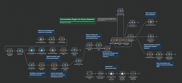

I managed to get a multi-character system where you say “Switch to Joanna” or the name of the 12 characters in the system.

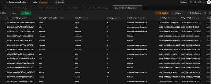

There is an AI Roleplay node in the middle.
The conversation data is on Supabase.
The “listening” after question mark forced and other code to clean up the response helps make it solid!
Your foundation really inspired me!
This workflow is for ElevenLabs, the cheaper ElevenLabs Flash v2 I think it was, a different voice is called based on the character, “Switch to Jason”, the Elevenlabs voice switch it sent to the Conversation Agent, then a new conversation_id begins and the last_char is contacted.
Open Router gave me 7sec turnaround trying Grok out, OpenAI and Anthropic no issues less than 1 sec. Going to test Gemini which should perform great even on the free tier.
I think the big thing I learned from this project is, build it and then adjust then keep building and have so much fun with Claude Code or Lovable or just straight up building something fun.
Last advice being when you build your master Character AI node, go
thanks!
For the character creation I went with this template and created 12 of them:

Having a Silly Tavern type conversation through my Home Assistant setup was the original goal.
For the end-result node “Respond to Webhook” and what “Webhook Conversation” needs is just the simple “output” and non-streaming.
So its like Home Assistant Voice Assist —> “Webhook Conversation” integration —> n8n Webhook catch —> n8n workflow doing the magic —> “output” Respond to Webhook node, JSON format.

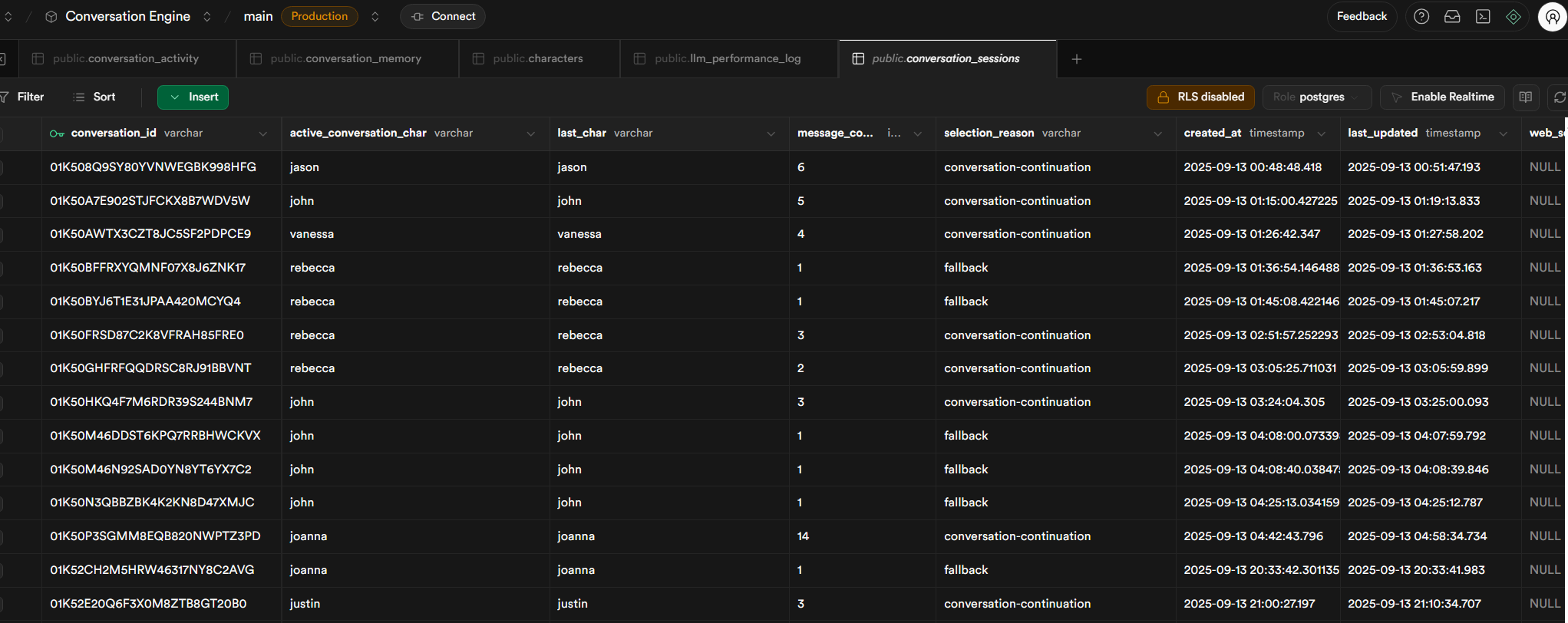

You can see the logic in the workflow how some other stuff is written to Supabase tables. Supabase gives you 2 free projects so you can easily set that up, you should already learn that for Lovable or doing n8n automations.
In the middle AI node you set the tokens, 120 if you want 3 sentences, tonight I had it at 500 and it was quite interesting where the AI waxed and flowed, but I like 80-100 tokens, 2-3 sentences, set it back and forth.
I’m more than happy to help anyone so hit me up here or on Github @ Nitroedge. The other things I have been interested in is running local TTS via Chatterbox and the S3 ESP32 Box customization.
Lennard, I’m a noob in terms of GitHub and learning to push in Claude Code, so total beginner, I deserve the punishment and mockery :smile:
I’ll share my JSON to import, Supabase SQL editor command to create the databases. That should totally get anyone running and load Lennard’s “Webhook Conversation” then webhook it to this n8n workflow and Supabase.
Get a S3 EPS32 box, or Atom Echo M5, or use your computer or mobile microphone to contact the Home Assistant “Assist” and this is the backend to that where you say “Hey Jarvis” or any of the existing wakewords.
I’m using Bobba’s S3 box custom firmware, but get anything working as a satelite and responding your gold, then you can build what you want! Microphone or mobile or whatever is your pleasure,
Input in —> all good stuff Home Assistant and n8n and databases then —> output speakers (S3 Box with Bobba’s firmware enables external_mediaplayer in the options, boom!).
The REST API will work but one thing I learned with my HTTP Request webhook work is turn off logging because it overloaded my setup.
Straight up Webhook Conversation to any online service I think is the best approach to gather the non-streaming simple input —> end node of “output” in JSON format so the Voice Assist announces it gracefully
