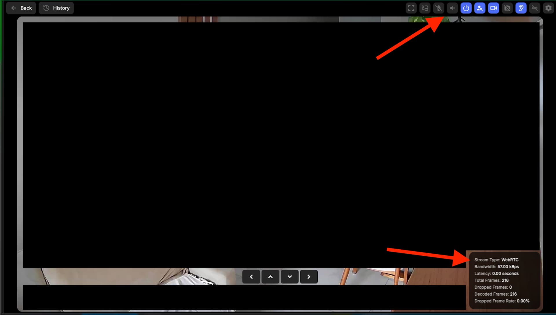

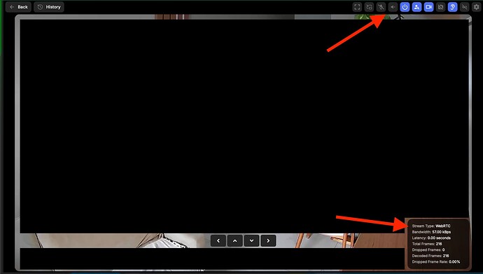

In the computer and in the app (local or remote with tailscale) the video stream usually goes to WebRTC.

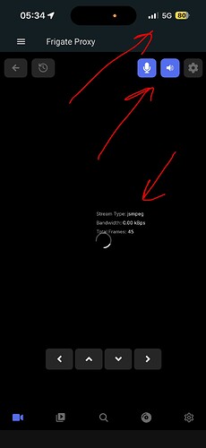

Now in the APP, with Nabu Casa configured, when using the wifi WebRTC is the usual stream type. However, when on remote/5G, it only goes to jsmpeg and this way the two-way audio does not work.

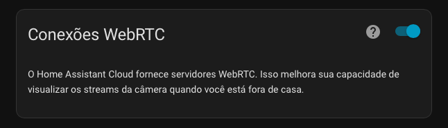

Nabu Casa does have WebRTC connection enabled in the home assistant cloud settings.

Well if it is using jsmpeg that can indicate that is using substream that you don’t for some reason get on your mob.
When I test my cameras in go2rtc they are using rtc for streaming on local network.
It also might be that you miss configured your frigate config. It is guessing game by the info you provided.
Edit:
Did you clicked on enable frigate native webrtc support on frigate integration ?
I have this disabled.
Mine is disabled too.
Managed to solve this by adding a port forwarding rule for port 8555 in my router… though not ideal, it was the only way that I managed to make it work.
