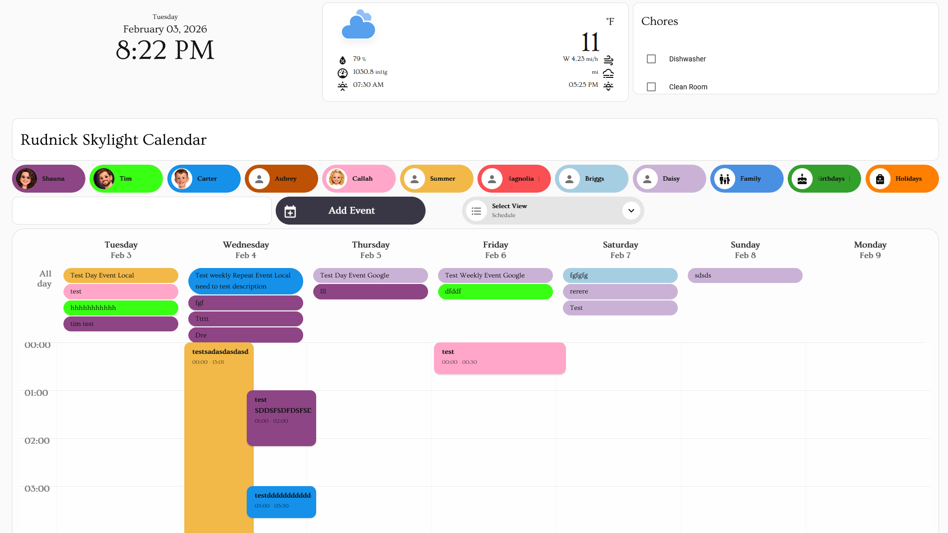

Week Planner Card Plus and ICS Calendar Tools

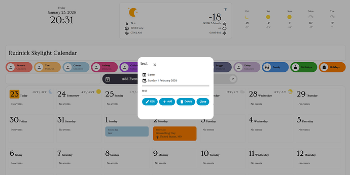

I Needed a way to edit, Delete and add events by just clicking the day and found week planner card but was missing these small things so i added them. Oh i almost forgot I made it responsive too.
This is working GREAT for my local calendars and google calendars. Working great for the DIY Family Calendar (skylight) project. Thought i would share and hopes other people find it useful too. (New)Google support now too for deleting events.

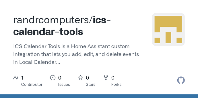

It does need my other new integration “ics calendar tools” this allows deleting and updating local calendar events.

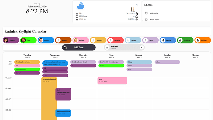

New “schedule” view
I tried to document everything as best i could so any questions post here or repo.
with this you need to use new card just add “-plus” to card in yaml as example type: custom:week-planner-card-plus this is required for card to work and is in documentation.
Here is link to my custom integration “ics-calendar-tools” that is required for local calendars i want to keep all i can local.
Note certain calendars have limitations. CalDAV cannot edit or delete events. But you can add events Google cannot edit events. But You can add and delete events Local calendars you can delete, add and edit events with ics calendar tools addon!

  • Clicking a totally empty day opens Add
  • Clicking empty space within a day that already has events opens Add
  • Clicking an event opens Edit (and the calendar is preselected based on the clicked event)

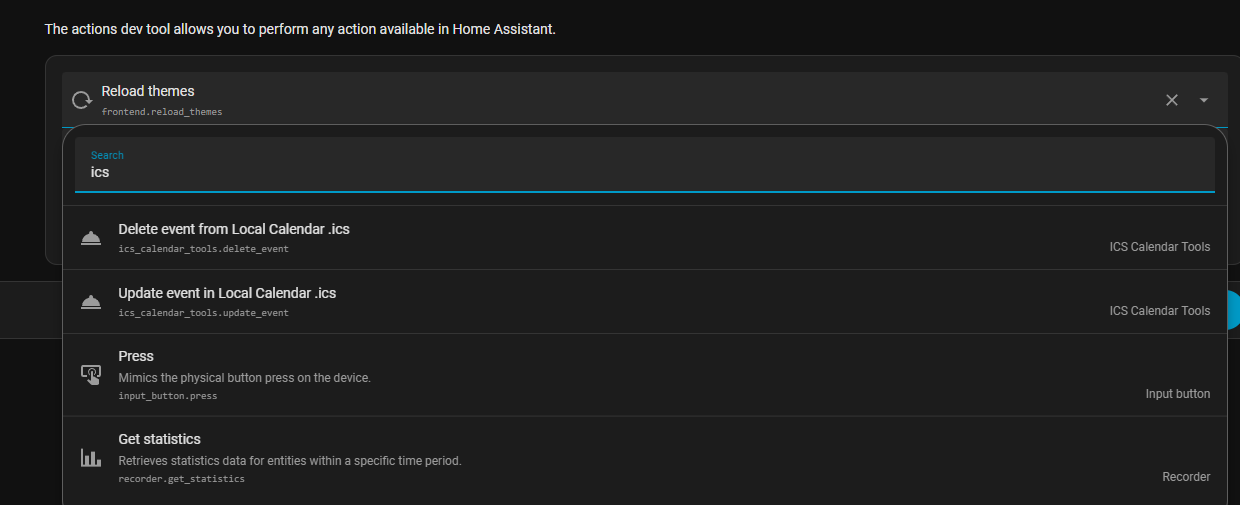

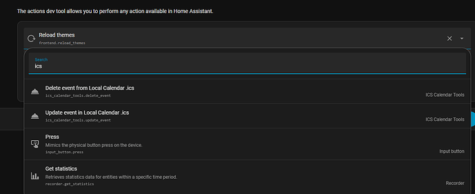

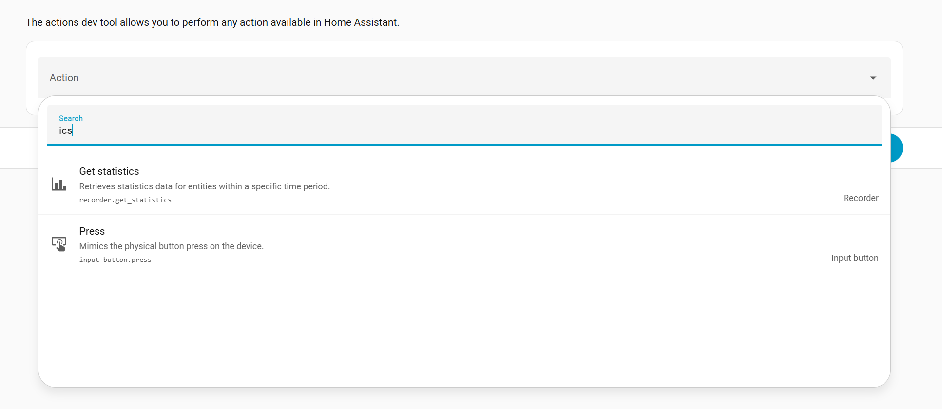

If you go to developer tools then action and search for ics does it show anything? Should show 2 entities
I will work on adding google support i think thats by ID not ICS so should be doable
I did reboot the HA server instance after installing the second integration, and no change in behavior.
In regards to the entities, are these the correct ones?
no you should see these delete event from local calendar and update event in local calendar

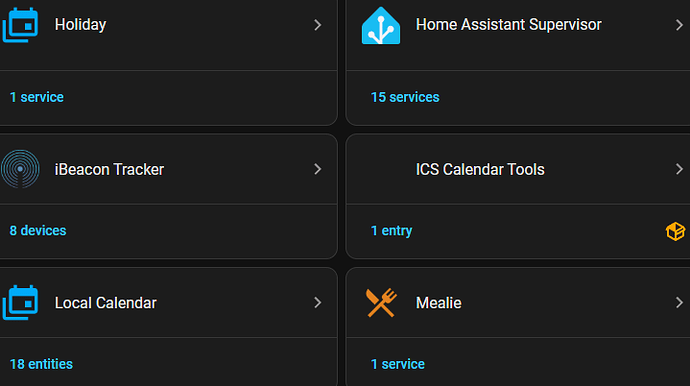

did you actually install in home assistant? it should show in “integrations”
@emblaochist ill install google calendar integration and will write support for “event ID” into tool. give me a day or 2. For now once you get ics tools installed correctly give it a test with local calendar it works very good but google support coming soon.

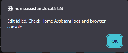

I have it but tapping a day doesn’t see, to do anything and attempting an edit on a Google calendar event fails:
I have the ICS Calendar tools integration installed too.
You might have installed v1.1.9a check hacs again should be v1.1.9 I reverted code but hacs might have kept the “a” version. Check hacs again and install v1.1.9. Sorry about that. 1.1.9 works trust me :slight_smile: maybe select different version from hacs download and manually pic 1.1.9 reinstall and it will work.
@Orange-GT3 Also edit is not supported on official google integration so it wont work in our calendar only Add and Delete are supported. Thats what version 1.1.9a was attempting to do is get editing event working for google but we cant even edit a google event in HA native app(local calendars we can actually edit, delete and add). so if you can Add and Delete google event that is where code is at current state. let me know if delete works and if it does that is at this point best we can do. i am working on getting edit for cloud based working and also adding the option for repeat events but this will be in version 2.0!

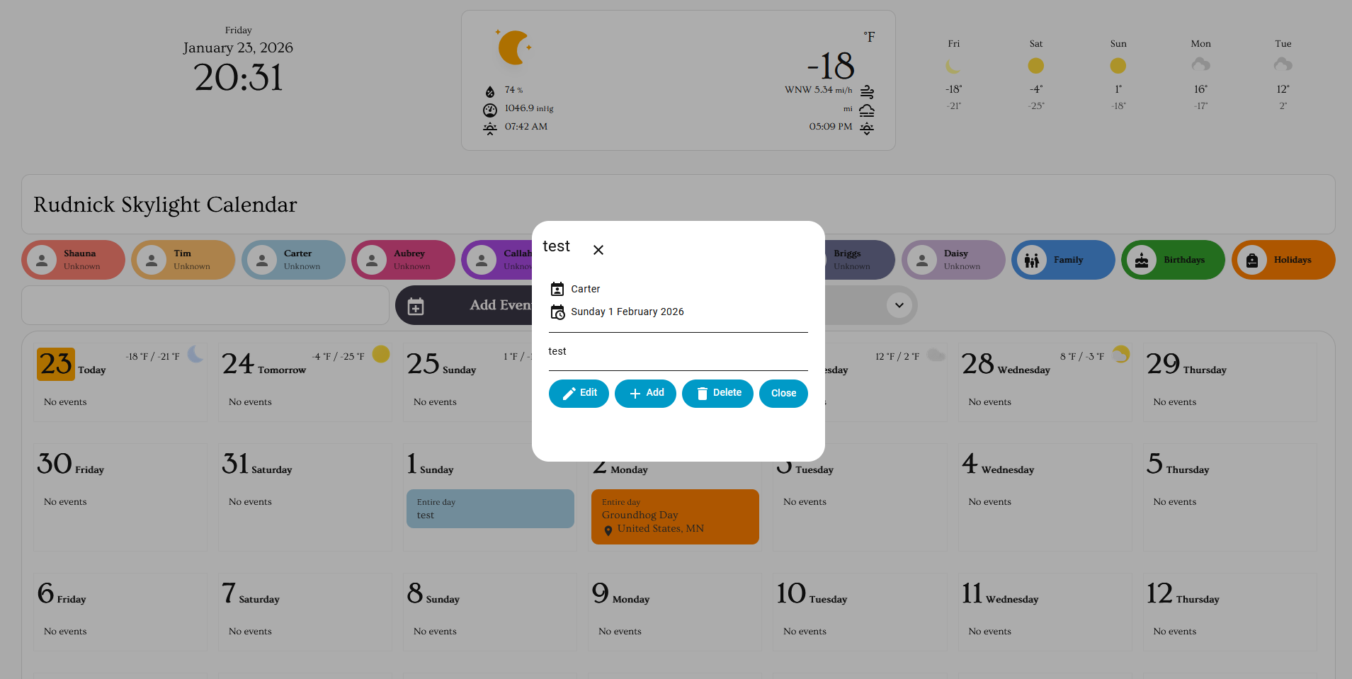

It does. I added a new event using the original ‘Add event’ button and when I clicked on it and hit ‘delete’, it got deleted.
Clicking on an empty part of the calendar does not trigger an ‘add’ though. I can see ‘add’ when I click on an existing event…
clicking empty “Day” should bring up that same add event dialog. maybe my add event script is different then yours? but even if that was case it should still open dialog on empty day.
