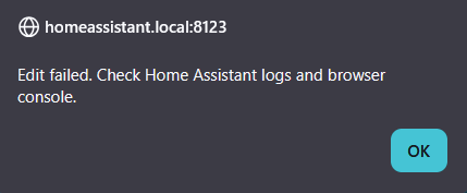

I’m using the original ‘Add event’ dialogue still and that adds an event OK.
I go to edit it and I get this error:
The logs show this:

The error relates to a Local Calendar, which I’m not using.
@Orange-GT3 You cannot edit google events from Home Assistant UI its just not supported. If you use Google only, then all you can do is Add/Delete events from UI. This is a limitation in the Google integration within home assistant and not anything to do with week planner card plus. That said i could make it so edit is not option if google detected to eliminate confusion.
** You should upgrade both integrations in this thread and use the new popup you can always use old Add event" button at top if you wanted to.
You did say this previously, but it slipped my mind. Thank you.
I think that would help, yes.

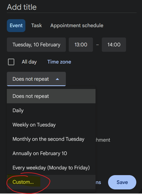

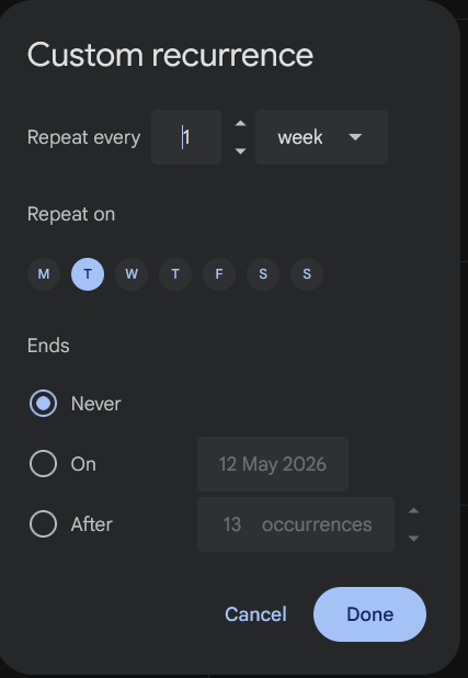

Is it possible to add the Custom option for recurring events, as per the Google Calendar?

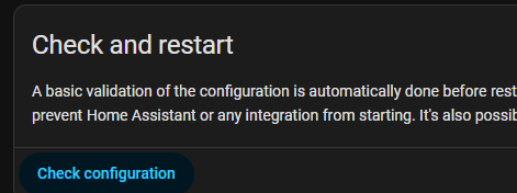

i have not tested but if you put this in configuration.yaml it should work. TEST change in developer tolls first by “check configuration” before restart.
Open /config/configuration.yaml
Add this at the top level (not indented under anything else):
input_boolean:
  calendar_all_day_event:
    name: All Day Event
    initial: off
