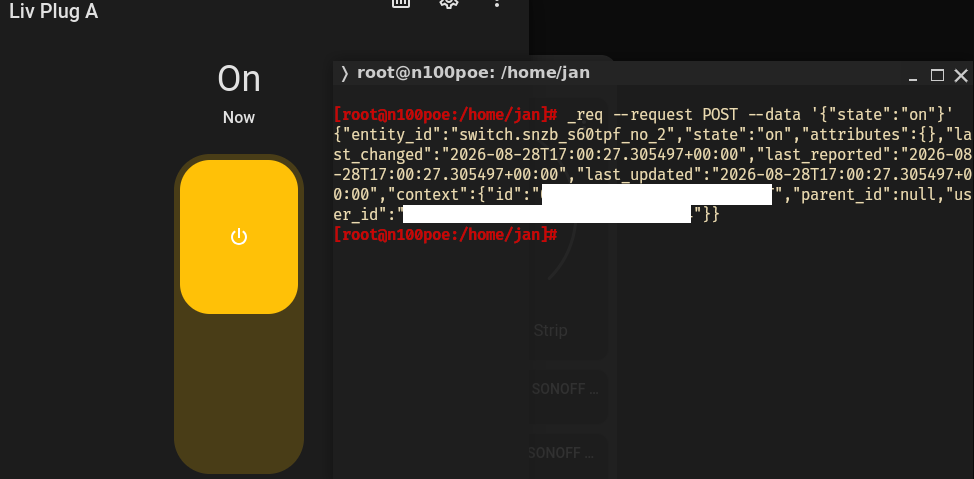

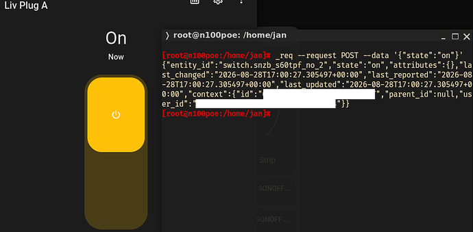

But when I try to turn power on with the REST-API:
$ curl --header --request POST "Authorization: Bearer $(cat /etc/secrets/ha-token)" --header "Content-Type: application/json" \
    --url http://home-assistant.local/api/states/switch.snzb_s60tpf_no_2 \
    --data '{"state": "on"}'
{"entity_id":"switch.snzb_s60tpf_no_2","state":"on","attributes":{},"last_changed":"2026-08-28T16:54:54.792177+00:00","last_reported":"2026-08-28T16:54:54.792177+00:00","last_updated":"2026-08-28T16:54:54.792177+00:00","context":{"id":"....","parent_id":null,"user_id":"..."}}
the power doesn’t turn on but on the web interface, I see the status change. Again, when I’m using the slider in the web-UI, I hear the relay click and the connected consumer turns on, but not with REST.
What am I doing wrong?
Remark: I’m not filing a bug-report yet, because I assume this is intended behavior and I’m missing or misunderstanding something, since I’m pretty no to HA. But I’m open to, if that’s not the case.
You are just updating the state in the state machine, which isn’t the same as calling the service that actually turns the switch on/off.

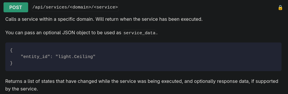

What would I put for <domain> and <service> as the documentation suggest (see picture) or how do I find out?
The domain is switch and the service would be turn_on, turn_off, or toggle… depending on what you are trying to do.
A yes, thanks. That seems to do the trick:
