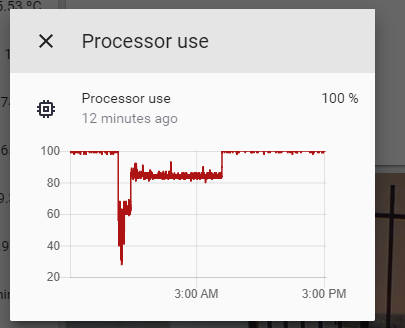

Does this strike anyone as weird? The spikes I can understand might be for a reason but what could cause my processor usage be around 35% and then suddenly drop to less than 10%?
Just curious…
Hassio / HassOS on a Pi
Just curious…
Database scrub? Check your log files for the time in question.
HassOS on Pi 3 :S
Do you have any custom somponents active?
If so deactivate them and see if that helps
What Hass.io addons are you running?
Try stopping them one by one and see if processor usage drops…
thx for the inspiration
ftp server (whitout any file transfer or clients connected) cause 25% more cpu usage
