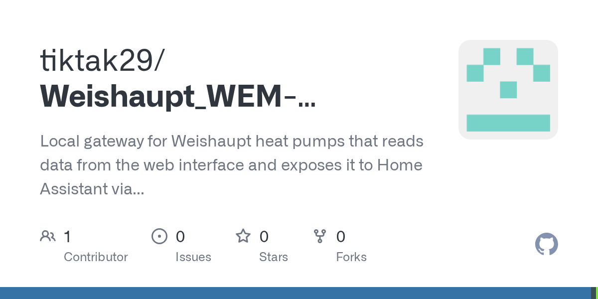

I've developed a local MQTT integration for the Weishaupt web‑interface controller.
It reads data directly from the built‑in WEM web interface and publishes it to Home Assistant using MQTT Discovery — completely local, cloud‑free, and without requiring Modbus access.
Currently, it supports data from the heat pump, heating circuits (HK1/HK2), statistics, and the secondary heater (2. WEZ).
It has been tested with a Weishaupt Aeroblock WAB 14 heat pump, but feedback from users with different WEM configurations would be especially welcome.
You can find the repository here:
If anyone is interested in testing it, I'd really appreciate feedback, bug reports, or ideas for improvements.
