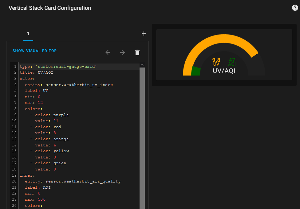

Shouldn’t the UV bar (the outside bar) be red? What am I missing?
I’m using the dual gauge HACS card. I was able to get red to show on the AQI (Inner Bar) but, for some reason it refuses to show on the outer bar.

Here is the code:
type: 'custom:dual-gauge-card'
title: UV/AQI
outer:
entity: sensor.weatherbit_uv_index
label: UV
min: 0
max: 12
colors:
- color: purple
value: 11
- color: red
vslue: 8
- color: orange
value: 6
- color: yellow
value: 3
- color: green
value: 0
inner:
entity: sensor.weatherbit_air_quality
label: AQI
min: 0
max: 500
colors:
- color: maroon
value: 301
- color: purple
value: 201
- color: red
value: 151
- color: orange
value: 101
- color: yellow
value: 51
- color: green
value: 0
If I set the state to something like 8.5 it still shows as orange, which doesn’t seem correct.
Look At your spelling
vslue
Hmm… interesting. It seems that spellcheck is disabled in the form box. I mean, I shouldn’t’ve needed it, but still.
Tested and confirmed.
Thank you.
