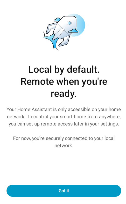

I've been beating myself up trying to establish a remote connection via a noip.com ddns address. Port forwarding is set up on my router and included in my DDNS http address as such: http://myddns.noip.com:8123
I'm having no success, but I just got the screenshot message which says it can be done, but nothing about how to do it?
