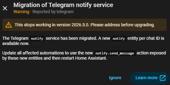

What do I fix?
What exactly should I look for in my automation.yaml?
I changed all those old telegram to use the telegram_bot’s YAML, but this warning persists…

I assume this is generated automatically by HA based on the features the integration is using (rather than the integration), correct?
The Learn more led to this Telegram bot - Home Assistant
Change the notify action to notify.send_message and use the notify entity

Searching for notify., I find a ton of service: notify. and action: notify., none of them are related to telegram

I had the entire /config searched by VSCode for notify., I’m not seeing anything else.
Are you sure you know the telegram notify service name?
  1. I don’t understand what you are asking.
  2. I searched for notify., everything that appears beside it is unrelated to telegram
  3. In the earlier screenshot, those were notifications to the android companion app
Right, you’re searching for service that you don’t know the name of and you don’t see the problem with this? You’re convinced all the ones you found are not the telegram service, but you don’t know that for sure because you don’t know its name. Are you following me now?
I.e. Find out the name of the service and then search for it.

That’s telegram bot integration, not telegram integration. They are different.
look in your notify section for
platform: telegram
Nothing, I don’t have such a line anymore
So then your home assistant is hallucinating and making things up
Did you restart HA after you deleted that? If not it’s still in memory.
