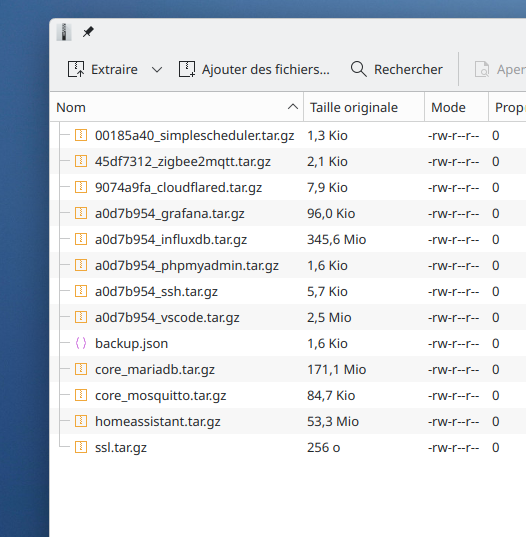

To be sure, make an unencrypted backup, download it to your PC and open the backup with 7Zip.
AFAIK the InfluxDB is saved if you use the InfluxDB add-on. Same for Grafana.
If you use the Zigbee2MQTT add-on, it is saved too.
Oh thanks, looks like it does.
