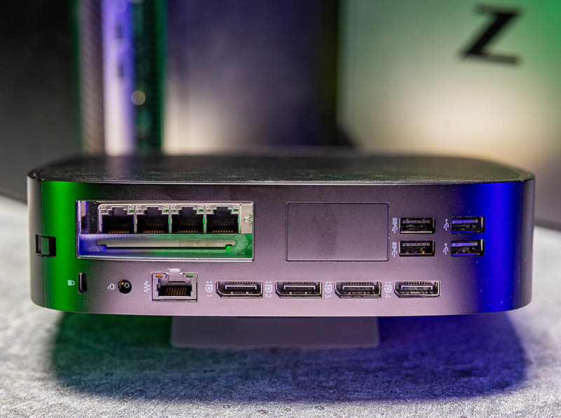

I’ve been using HP Thin Clients, the HP T730, then T740. Can get them from eBay for $100-200, and the T740 at least comes with a 2000 series Ryzen processor and integrated GPU. Has room for a Coral, 2 NVME SSDs and 10GBe network card too.
