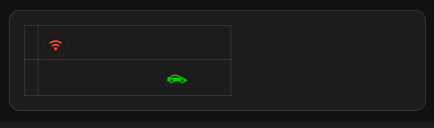

Hi @WarC0zes,
okay, so it’s clearly not that simple. These example no longer work after replacing card_mod with UIX.”

What’s not working?
Your code gives me this result.
popup2
it looks like this
card_mod has been removed and if I replaye card_mod with uix: then it looks like what you can see in the screenshot.
if I replace uix: with card_mod: then it looks ok.
is there anything else to configure?
You need to remove card_mod from HACS and install uix. Then restart HA.
Just in case, clear your browser cache.
Otherwise, there’s nothing to configure.
