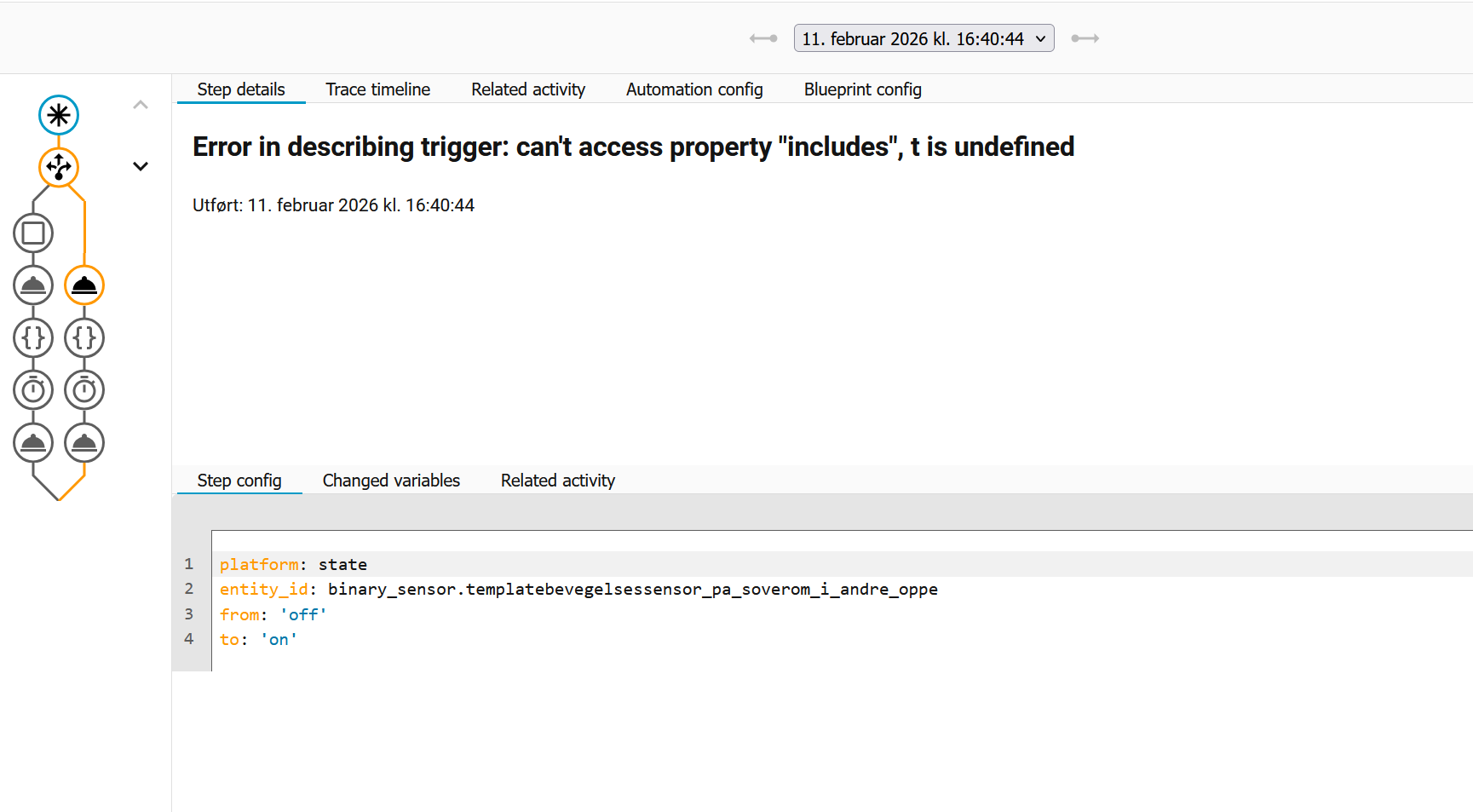

Here’s a screenshot of the error message for the same automation, which now works since I have recreated it:
Can you post that please
Of course! Thank you for takinge the time to look at this! Here it is:

Everything looks fine, you should probably craete an issue on homeassitant/frontend on github with this data.
Thanks, I will try! I thought this had to be something in the inner workings since the automations didn’t work at all until I recreated them, but can it still be the frontend?
it likely still is frontend, unless you can show the backend log with an accompanied error
Damn, I wish I hadn’t recreated those automations… I looked at the log from today, and I couldn’t find anything regarding that there. Maybe this is one of those ghosts that can’t be traced, since I see that the error has been reported at least since 2024. :frowning:
Issue created, I hope it is in a format they will accept. At least I tried. :grin:
