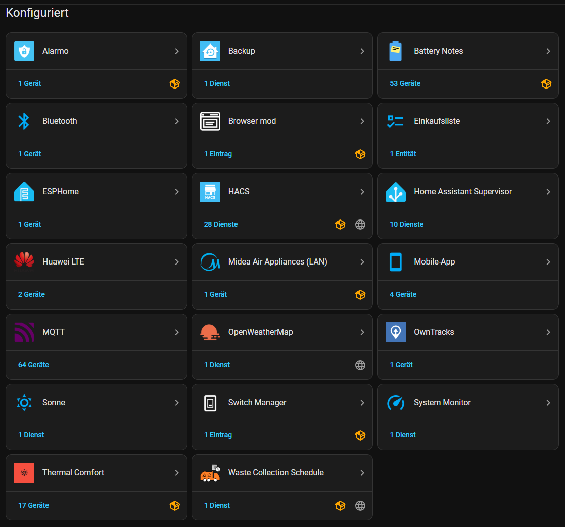

I don’t have many integrations installed and none of them seem like a likely candidate:

I see three cloud based integrations
that could be doing it. image
HACS, OpenWeatherMap and Waste Collection Schedule.
True, OWM has a steady data usage, same for waste collection, but those are minimal. I think I even disabled them for testing once, but I’m currently unsure. Will attempt to do so again, as they are not critical to me yet.

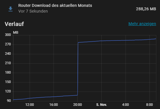

This is how the usage looks like btw:
HACS does regular updates which requires downloading an index of many integrations.
There also are 4 devices using the mobile app. There could be a lot of traffic, depends on the settings
Running any addons?
They all have an Autoupdate feature.
Does this always happen at the same time (in this case 20:00)?
Thank you for the pointers. It seems that lately the spikes have actually gone down in frequency, to about once a month. Last time it was at 8pm of November 4th, the time before that at 7pm October 4th.
