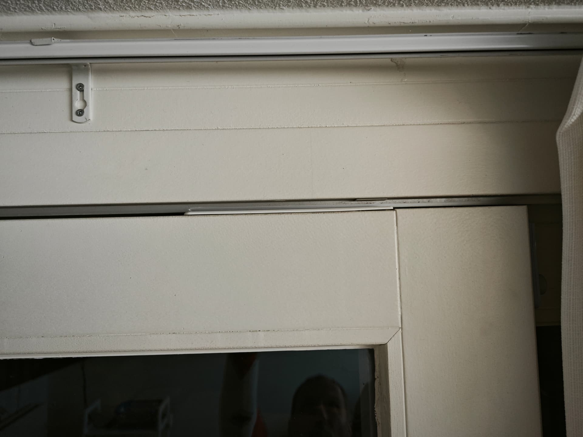

Hi everyone, I’m looking for advice on discreetly installing door/window sensors.

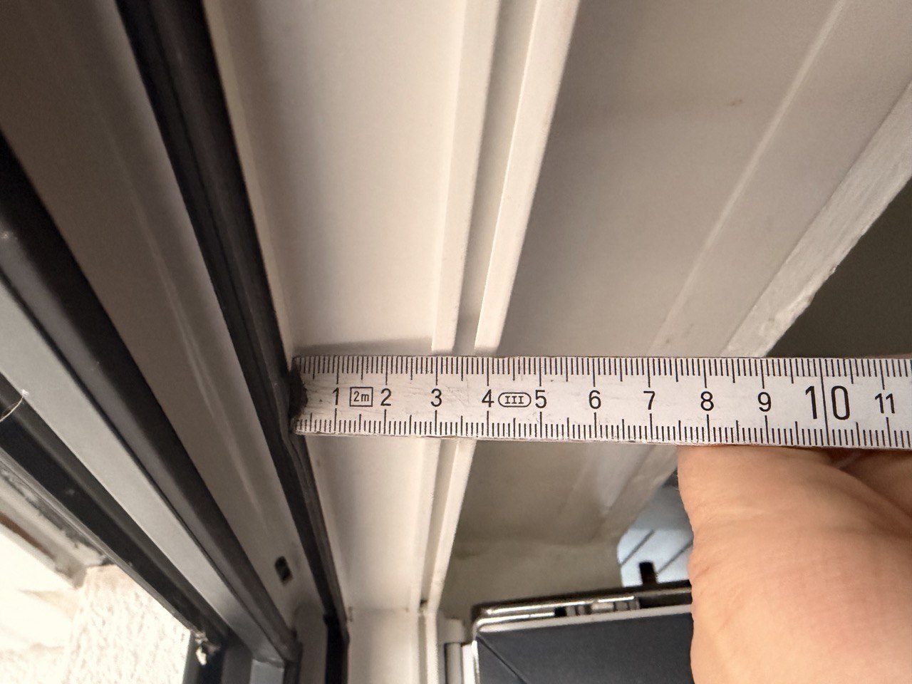

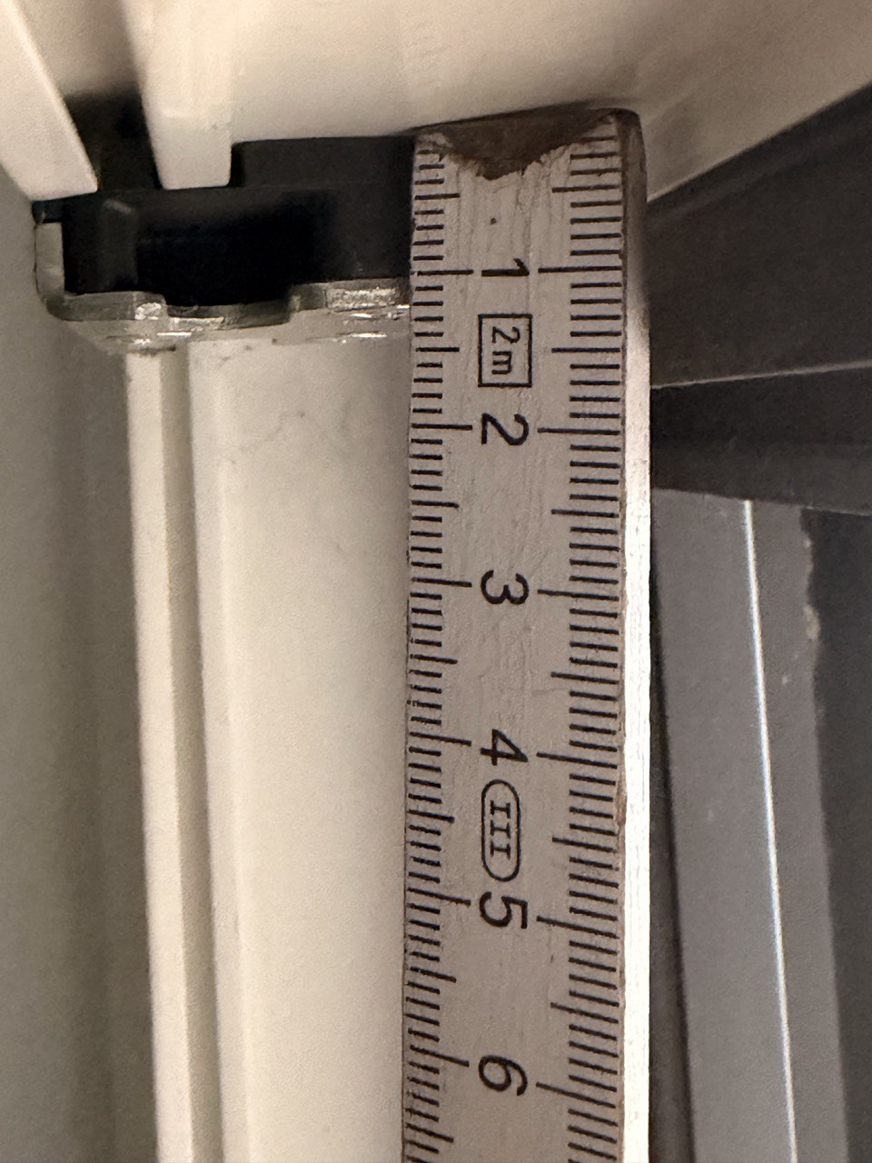

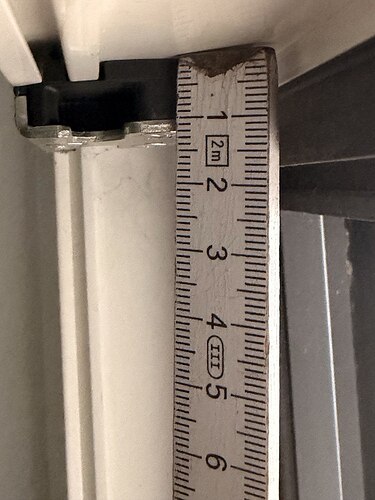

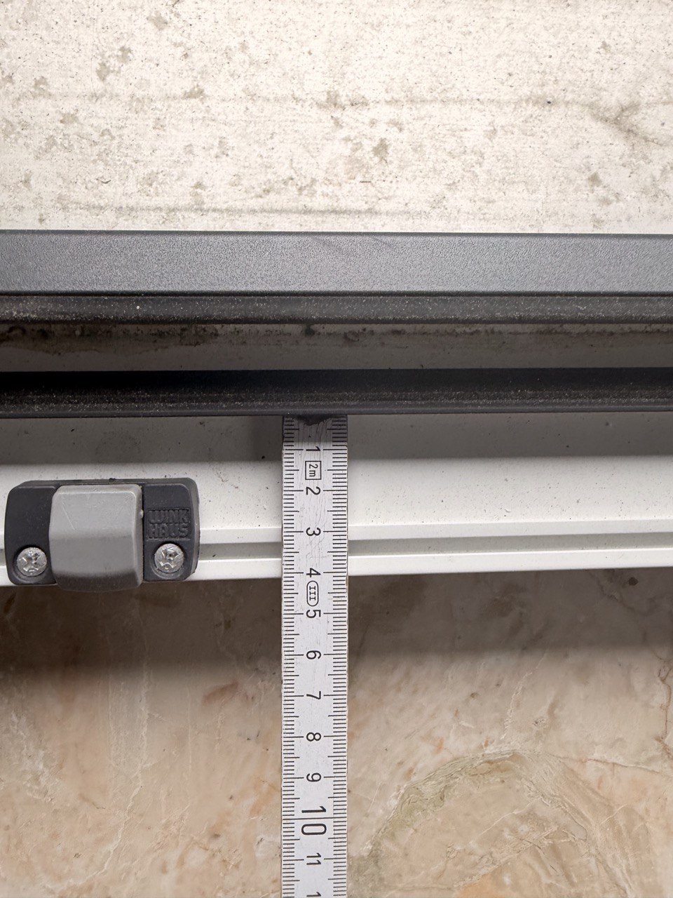

I have triple-glazed windows and doors, and unfortunately I can only fit sensors that are max 29 mm wide and around 12 mm thick inside the frame.
I was considering the Shelly BLU DW, but it’s 35 mm x 35 mm x 7 mm, which is too large for my setup. ( also also not ZWave)
Which Z-Wave door/window sensors are you using that are small enough to be hidden inside the window frame?
Or can you show me your solution ?
Ideally something compact, reliable, and compatible with Home Assistant.

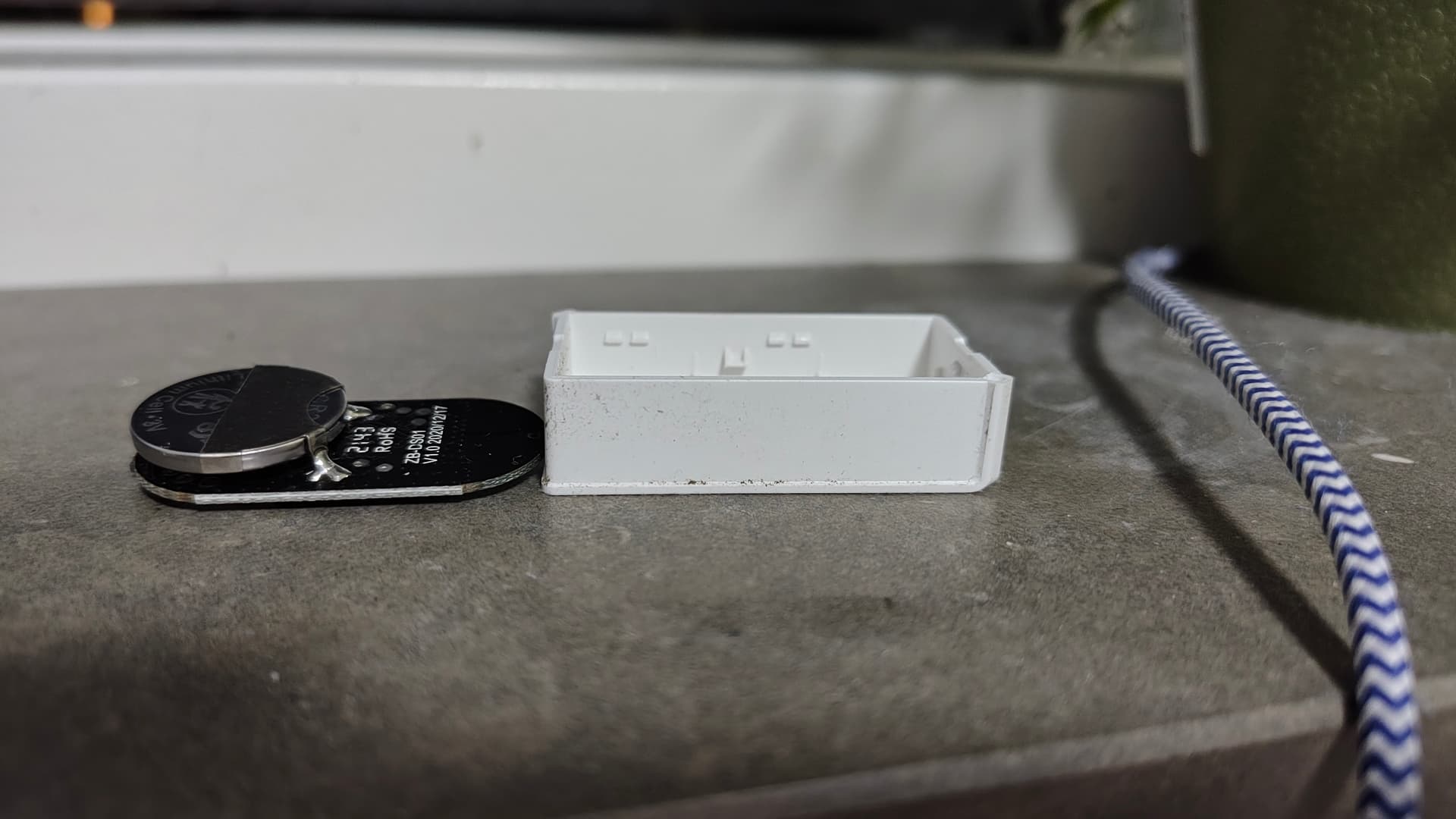

If you remove the plastic then the PCB and magnet is very small.
Shouldn’t be an issue to fit it there.
Not sure about humidity though.
I would expect it to be rather wet in that area with the mixing of cold and hot air
remove the plastic of with sensor exactly ? do you have ref ? and also tested ?
No… but the plastic is only there to protect it and make it pretty.
The version I have needs to be stripped to replace the battery, so technically I have tried it…

Remove plastique will not help … perhaps 1mm smaller …

And solder off the battery and place it on wires and you have a very very tiny device.
what is this device ?
I have 2 of these, perfect functioning and now at 50% battery . Dont even recall when i bought Them, but its been years ago

I have still Zwave swindows sensor and tried withot the cover but only saved 1-2 mm … :confused:
i guess i have to buy a new on , more compact
The only Problem is that t change the battery :confused:
No i can 't use this solution for my windows / door
