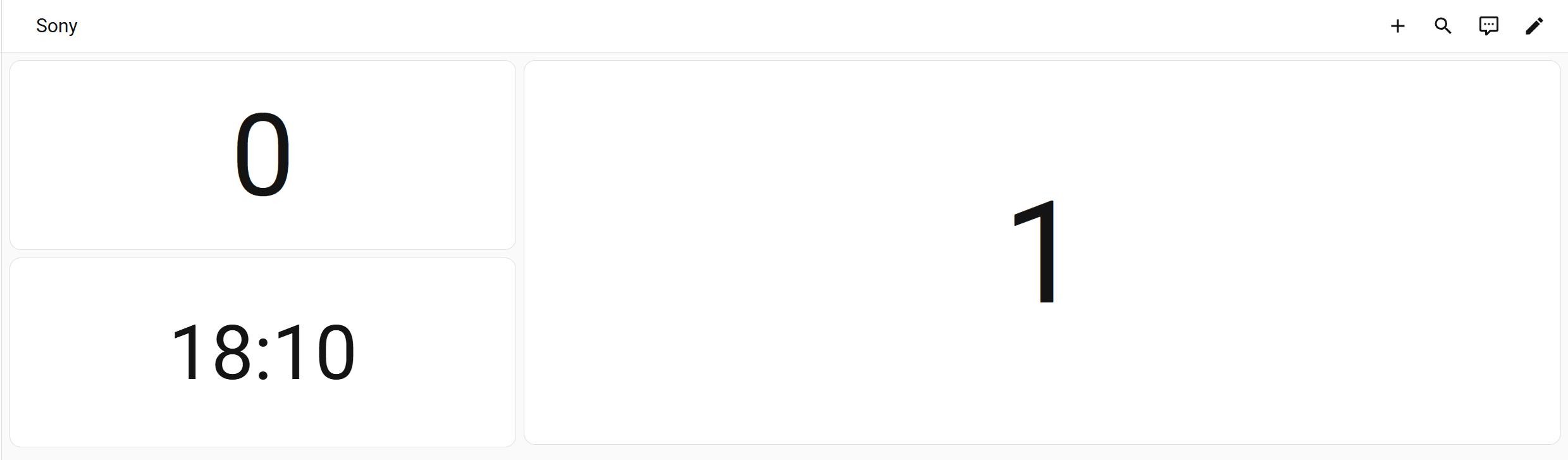

Here’s a picture of about what I want to achieve. This is very easy to make in the boating software SignalK, but not very customizable. I want to keep everything in Hass, and I want to remove the labels. The depth when I’m docked is 1 meter, and the speed is 0 knots, anything else would have scared me! :joy:

@boheme61 Thank you very much for answering! Yes, those bars are just the phone. :grin: Ideally I want it to be only numbers when it’s done, even removing the borders around the cards, if that’s possible.
The bottom one looks like a very good way of doing it, but I must be doing something wrong, because I’m just getting the icons for the sensors, not the value. Here’s a screenshot from my pc where I worked on it:

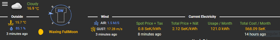

I copied and cleaned something from one of my views, not sure it will fit yours
Try to copy/paste this and go on from there

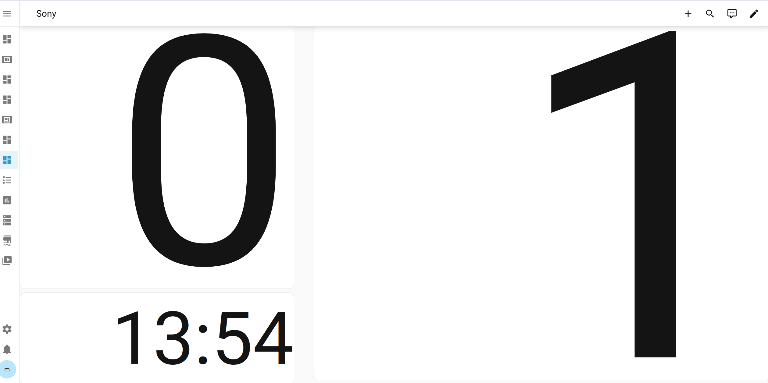

Weird, I thought I followed the instructions. Anyway, I have arrived at something close to what I want, the only thing I can’t get it to obey is alignment. I would like to do away with the borders too, but that’s not very important.

align: center isn’t doing anything I would expect CSS to do.
That code looks very odd to me, in my laptop/phone
Please show what your View-type is
Edit Dashboard , Then the “Pensil” to the far left !
by align, do you mean this ?
I amended the code to fit to the phone, it didn’t scale.

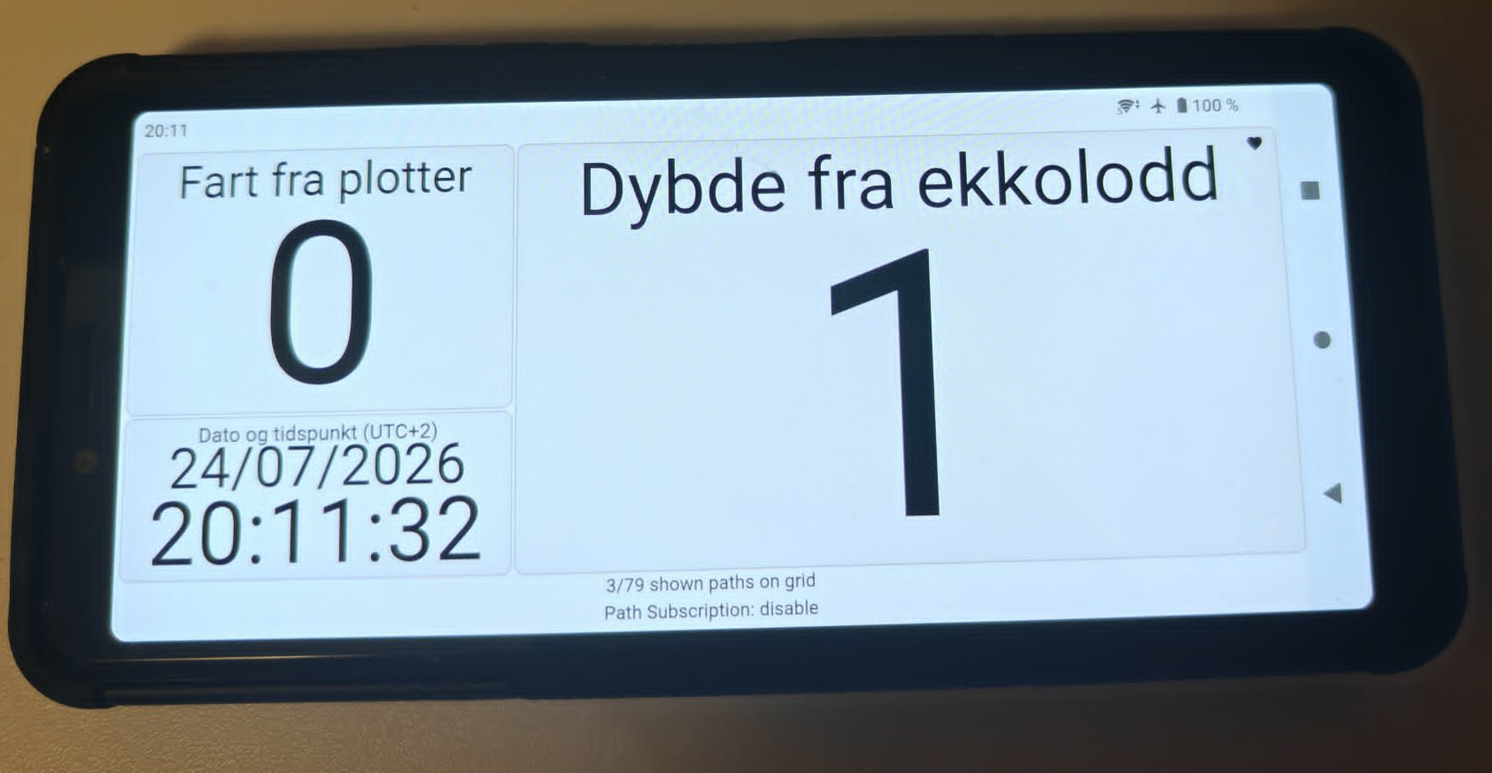

Thank you! That was so close to what I want that I’ll set it as a solution! I would prefer to remove the borders and the light grey backing, but I don’t know if that’s just an easy fix? I searched but couldn’t find an all white theme. I adjusted the height to fit the rather low and wide phone I’m going to use it on, so like this:

And I have probably reached my incompetence level… I have never tried to create a theme before. I created this in the config.yaml, from this page in the documentation:
frontend:
  themes:
    ingenbord:
      primary-color: pink
      border-color: 'none'
      background-color: '#ffffff'
      ha-card-background: '#ffffff'
      card-background-color: 'var(--ha-card-background)'
And then in the Dashboard:
views:
  - theme: ingenbord
    type: custom:grid-layout
    layout:
      grid-template-columns: 33% 67%
      grid-template-areas: |
        "area1 area2"
        "area1 area2"
Maybe the file should have another name or something?
But at least I found the way to remove the border, even if the bakcground color isn’t all white. But I can probably get around that by adjusting the width of the cards. The correct code to remove borders with card mod is:

Activating the theme for all of Hass did work, in the sense that it made everything greyer and the current dashboard in the left menu pink! :joy: So obviously it is doing something. I see now that with the standard theme activated and this theme only on the Sony phone page pink is the accent color when holding the mouse pointer over a tile in edit mode. But the background color stays the same. Anyway, I think I’ll just let the tiles go into each other. So again thanks a lot for the help! Skål med en bajer! :clinking_beer_mugs:
? , maybe Devs have used another “White” … just to piss of people :rofl:

I tried to add that to the theme, and even (after a bit of searching) ha-view-sections-column-gap: 8px but it doesn’t do anyting, probably because this is a custom grid. And I don’t use dark mode at all, I want everything as white as possible, with dark text. So that’s not a probolem.
Well, it wasn’t like “Yesterday” i was skiing last time :laughing: , and my gear is most like now just “give away or throw away” , i doubt i ever will use it again
There is another " background-color-2: ‘#ffffff’ "
which is reasonable new, not sure where it’s used, but i’ve seen it in many Themes ( so i added it to my also )
But your right about the “margins/gap” i think …
I actually use another custom vertical-stack where you can apply UIX to all cards in the stack , i.e removing/set border radius to 0px, same with paddings and tinkering with margins
- type: custom:vertical-stack-in-card
  horizontal: true
  cards:
    - type: custom:button-card
This is all custom:button-card ( beside the compas-card and moon_phase )
( It’s in 2 columns of a 3 column-grid, and 1st row, 80px high row )(head1 & head2 in above HomeStatus-grid)
ohh and the default native weather card (hard uix styled)
