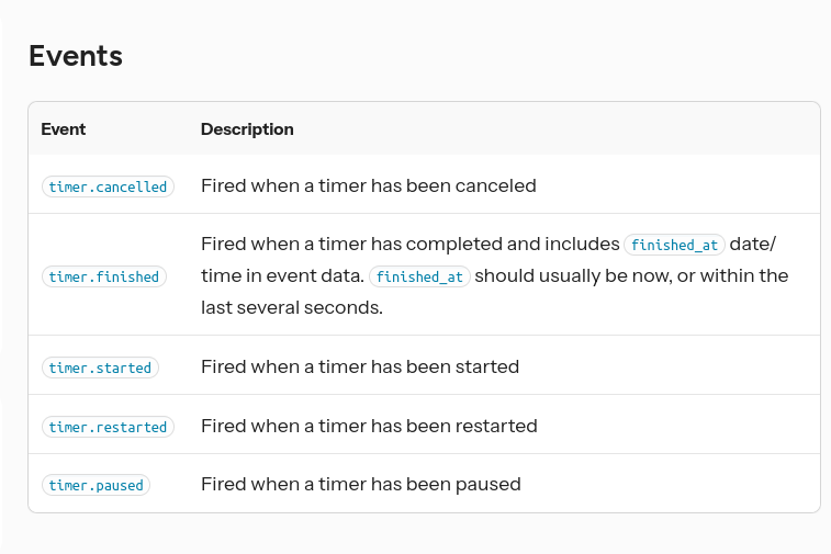

The Timer integration has specific Events that can be listened for by an Event trigger. But you would basically need to monitor all of them but timer.paused to capture all the events that would lead to a state of “idle” or “active”.

If you are adamant that you want to monitor “all” timers, use the timer events I linked previously:

If you wanted to use option #2, it would look something like this:
triggers:
  - trigger: event
    event_type: timer.started
  - trigger: event
    event_type: timer.finished
You would need to add addition triggers for the other timer events you were interested in, as well.
