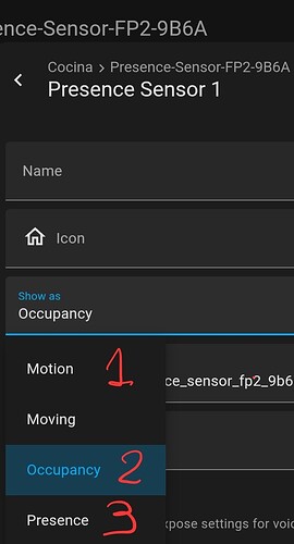

Today In was trying to build a dashboard showing all my motion sensors, and I have discover that I have three types of “motion sensors”.
The oldest one were motion, which makes sense.
Then some more advanced ones started to appear as presence, mostly milliwave ones.
But recently I have discovered that I also have occupancy sensors.
What is the difference between all those, and why would I want to have different devices that all I want from them is report if there is something in some room?
I get the difference between motion and presence, but why the additional occupancy?
For reference, see the attached picture
